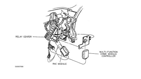

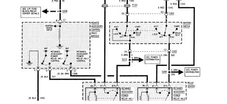

INTERNETMECHANIC
  • 700 POSTS
There is a rac module under right side of dash? I was pulling my hair out trying to find bcm. I don't have any hair to spare. lol
https://images.2carpros.com/forum/automotive_pictures/512072_rac_module_1.jpg
https://images.2carpros.com/forum/automotive_pictures/512072_rac_module_wiring_1.jpg
