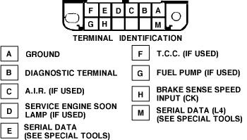

OK, lets see about pulling the codes..... Here's how..... To extract a trouble from the computer for diagnostic purposes, the Assembly Line Communication Link (ALDL) connector is used. Ground terminals A and B with the ignition "ON" and engine not running. The system will enter the diagnostic mode. In this mode, the computer will display a 12, three consecutive times, by flashing the "CHECK ENGINE", "SERVICE ENGINE SOON" or "MALFUNCTION INDICATOR LAMP" or light. A 12 consists of one flash, a short pause, then two flashes in rapid succession. After 12 is displayed, any stored trouble s will be displayed by flashing the "CHECK ENGINE", "SERVICE ENGINE SOON" or "MALFUNCTION INDICATOR LAMP" light. All s are displayed 3 times each then a 12 will repeat. In the diagnostic mode, the computer will also energize all computer controlled relays and solenoids.
https://images.2carpros.com/forum/automotive_pictures/188069_95bonnevillealdl_connector_1.gif
The ALDL diagnostic connector is located in the passenger compartment under dash. Here are some codes... 13 Open Oxygen Sensor Circuit 14 Coolant Temperature Sensor (High Temp Indicated) 15 Coolant Temperature Sensor (Low Temp Indicated) 16 System Voltage Low 17 Camshaft Position Sensor Circuit Error 21 Throttle Position Sensor (Signal Voltage High) 22 Throttle Position Sensor (Signal Voltage Low) 23 Intake Air Temperature (IAT) Sensor Circuit 24 Vehicle Speed Sensor (VSS) Circuit 25 Intake Air Temp (IAT) Sensor (High Temp Indicated) 26 Quad Driver Fault 28 Transaxle Range Switch Error 33 MAP Sensor Circuit (Signal Voltage High 34 Mass Air Flow Sensor (MAF) Circuit 35 Idle Air Control (IAC) System 36 Ignition 24X Signal Circuit Error 37 TCC Brake Switch Error 41 Ignition Control (IC) Timing Circuit Error 42 Ignition Control (IC) Circuit 43 Knock Sensor (KS) Circuit 44 Oxygen Sensor Circuit (Lean Exhaust Indicated) 45 Oxygen Sensor Circuit (Rich Exhaust Indicated) 51 Mem-Cal Error 53 System Voltage High 54 Fuel Pump Circuit (Low Voltage) 58 Transmission Temperature Sensor Circuit (High Temp) 59 Trans Fluid Temp (TFT) Sensor (High Voltage/Low Temp) 66 Low A/C Refrigerant Charge 70 A/C Pressure Sensor (High) Circuit 72 Vehicle Speed Sensor (VSS) Circuit 75 Digital EGR #1 Solenoid Error 76 Digital EGR #2 Solenoid Error 77 Digital EGR #3 Solenoid Error 79 Transmission Fluid - Over Temperature 80 Transmission Component Slipping 82 Ignition Control 3X Signal Error 85 PROM Error 86 Analog/Digital (A/D) Error 87 Erasable Programmable Read Only Memory (EEPROM) Error 90 TCC Error 96 Transmission System Voltage Low 98 Invalid PCM Program 99 Invalid PCM Program .
