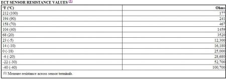

O2 sensor possibly because it happens after warm up. ECT and or TCC, TCC stays stuck on it should stall even cold tho...
https://images.2carpros.com/forum/automotive_pictures/62217_ECT_Table_2.jpg
Use this table for both the IAT and ECT testing. When it wont run unplug the O2 see what happens.

It does it right after startup, hit the key, it revs to about 2k and as it idles down like normal operation it sputters and dies. We have a parts car that still runs and I swapped the tps iac egr coils and ign module.
Iat and ect are normal.
