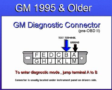

Well for 96 and newer it means the intake air heater control circuit has a problem, you have a 94? Test by crossing A & B terminals and count the flashes...640 is not a good code!
https://www.2carpros.com/forum/automotive_pictures/62217_GM_DLC95_Older_14.jpg
Cross these two terminals as shown, then turn the key on. Count the flashes, a 22 will flash as 2 flashes then a short pause, then 2 flashes, if more than one code is stored, the pause will be longer. The codes will display three times and end with 12. Write them down and post here. This connector is right under the middle of the dash...
