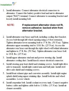

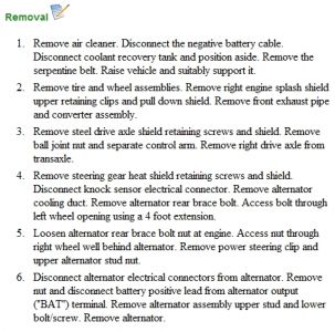

What are the step by step instructions for replacing the altinator for the 1994 pontiac bonnieville please email info back to emilysimon@gmail.com thank u

steps are below, email was also sent..
https://images.2carpros.com/forum/automotive_pictures/261618_Noname_2284.jpg
https://images.2carpros.com/forum/automotive_pictures/261618_Noname2_749.jpg
