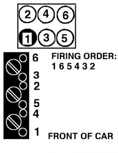

hello i have an problem i have change my ignition wire set and now it is not in order can you send an picture for me that i can see how it is.

hello rob2008 i want to know which number are matching with the front , of , vehicle and which i have to begin with.

https://images.2carpros.com/forum/automotive_pictures/181498_f_O_1.jpg
You can start with either one ,but make sure the wire are in the right order before starting the engine .Also if you didn't know the ,"1" on the coil matches up with the number ,"1" cylinder . and ," 2" on the coil goes to the number ,"2" cylinder ext... Let me know If I helped you any .

thank you very much rob2008 your instruction was successful finally i find the way to start my car with your help.
