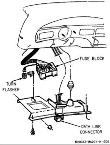

where is the data link connector located and how do i get to it
Aug 2, 2010 at 12:53 AM
  • 75,992 POSTS
Location-see below: Data Link Connector Behind LH Side Of I/P, LH Side Of Steering Column Support
