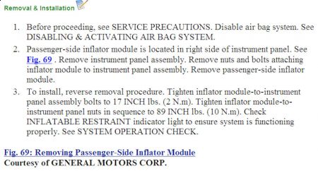

hi i need to replace the heater blend door atuator on my 93 bonneville sse. the only way i can see i get access to it is through the airbag cut out in top of dash. so my question is how do you remove the passenger side air bag?
Oct 4, 2009 at 8:07 AM
SERVICE WRITER
  • 9,123 POSTS
I didn't find a decent R and R on it..if this is it...
https://images.2carpros.com/forum/automotive_pictures/30961_bon_1.jpg

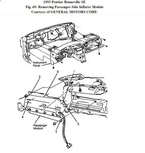

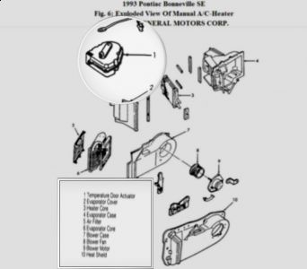

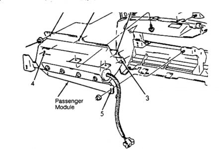

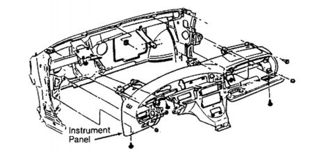

But this is what I found that You may need:
https://images.2carpros.com/forum/automotive_pictures/30961_bon1_1.jpg
https://images.2carpros.com/forum/automotive_pictures/30961_bon2_1.jpg
https://images.2carpros.com/forum/automotive_pictures/30961_bon3_1.jpg
https://images.2carpros.com/forum/automotive_pictures/30961_bon4_1.jpg
Oct 4, 2009 at 1:52 PM

is it neccesary to remove the entire dash assembly to gain acess to temp door acuator or is there another way?
Oct 5, 2009 at 10:49 AM
SERVICE WRITER
  • 9,123 POSTS
Well I spose there is always more than one way to skin a cat, but this is all I have and I'm not aware of another way.
