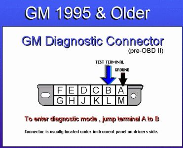

Service engine soon light on?
https://images.2carpros.com/forum/automotive_pictures/62217_GM_DLC95_Older_3.jpg
