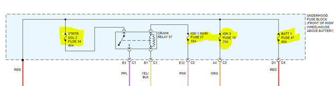

No crank, no radio or power windows
2004 PONTIAC AZTEK
183,000 MILES • 3.4L • 6 CYL • 2WD • AUTOMATIC
JAKE WARD
If I jump the starter solenoid it cranks but wont run. The radio and power windows also don't work.
Dec 28, 2019 at 3:48 AM
  • 110,194 POSTS
I suspect one of the ignition fuses has failed. I attached a picture below of the fuse box under the hood. I need you to check the fuses I indicated (highlighted) in the pic.
Next, if the fuses are good and there is power to and from them, check the starter relay. If there is another relay with the same part number, switch them to see if that makes a difference. If there isn't, I will provide a link that explains how to test a relay.
