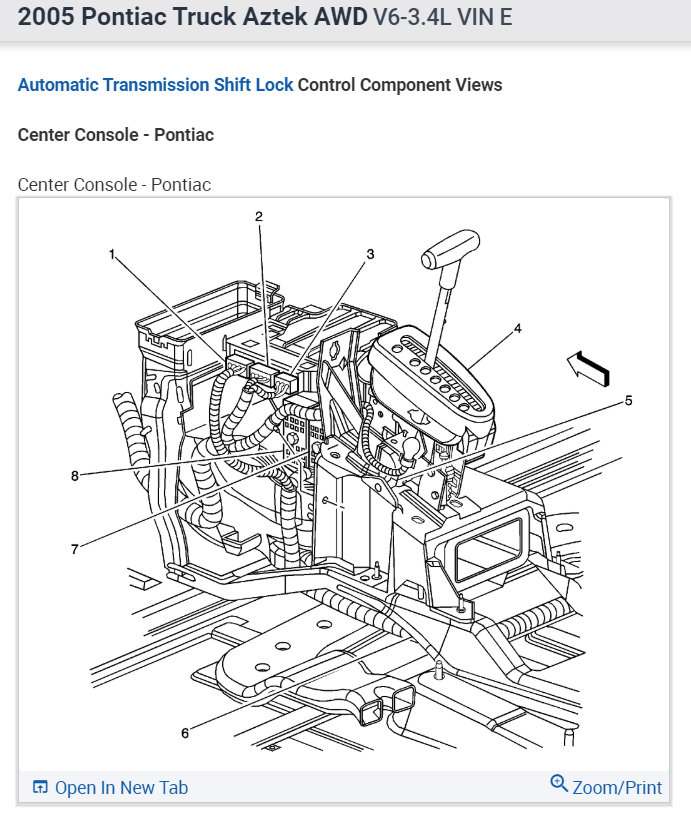

hi, it was driving fine i went to the bank, i went to leave & my aztek is stuck in park and I cant get the engine to crank over? can you help me
Jan 10, 2009 at 12:38 PM
  • 110,194 POSTS

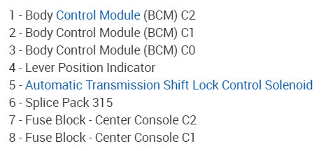

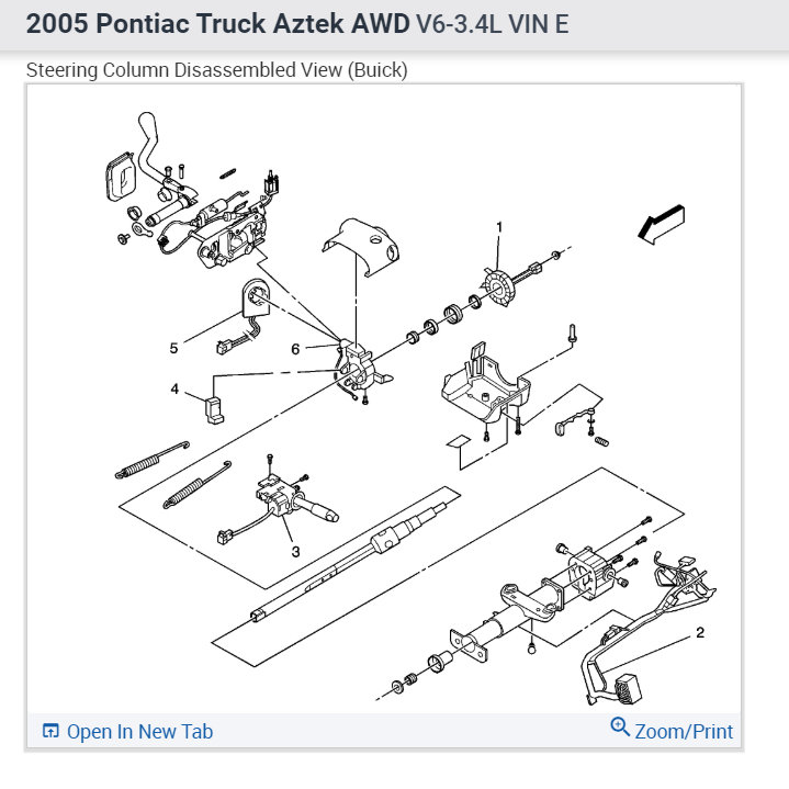

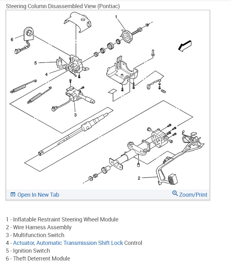

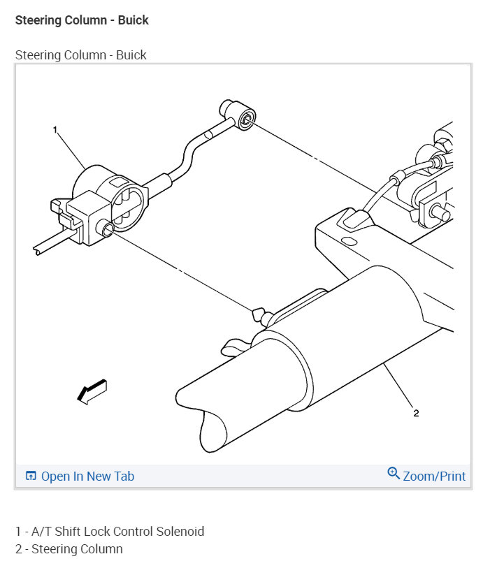

Are your brake lights working? The park lock solenoid functions from the brake light switch. If the switch isn't working, you can't get it from park. If that are it sounds like the interlock solenoid is not working here are instructions in the diagrams below that will show you how to replace it. Check out the diagrams (Below). Please let us know what happens.
