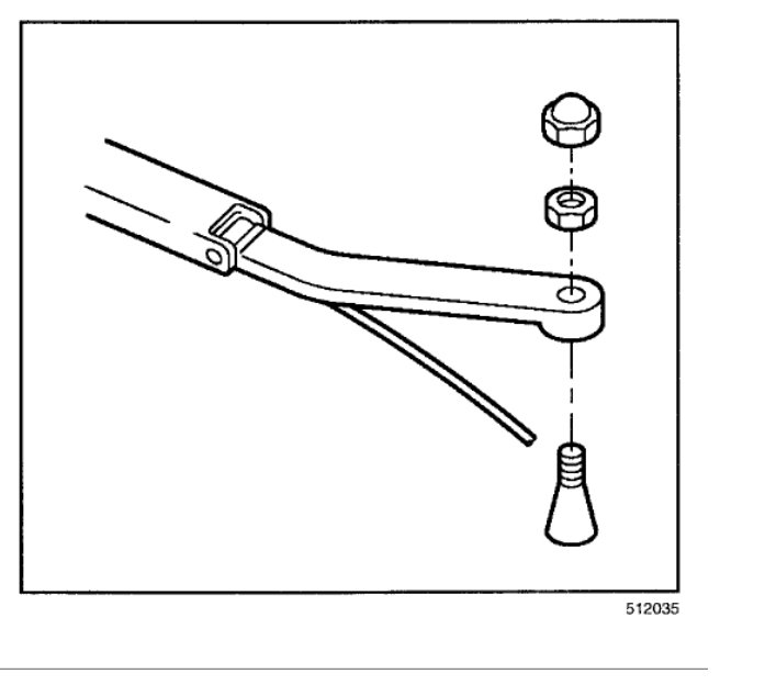

Passenger side wiper is not working
Oct 15, 2017 at 8:55 AM
  • 54,837 POSTS
I would check the pivot at the wiper arm to see if it is loose or stripped. Check out the diagram below so you can see what Im talking about.
Please let us know what you find. I'm interested to see what it is.
