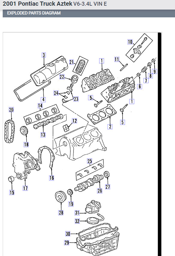

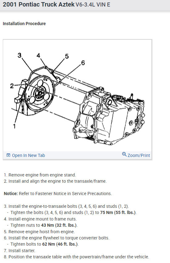

If so well I have future problems? I need to replace the engine, can you help me please?
Mar 5, 2010 at 4:19 PM
SQM
  • 6,383 POSTS

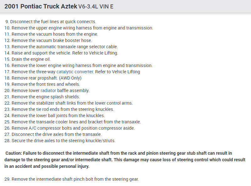

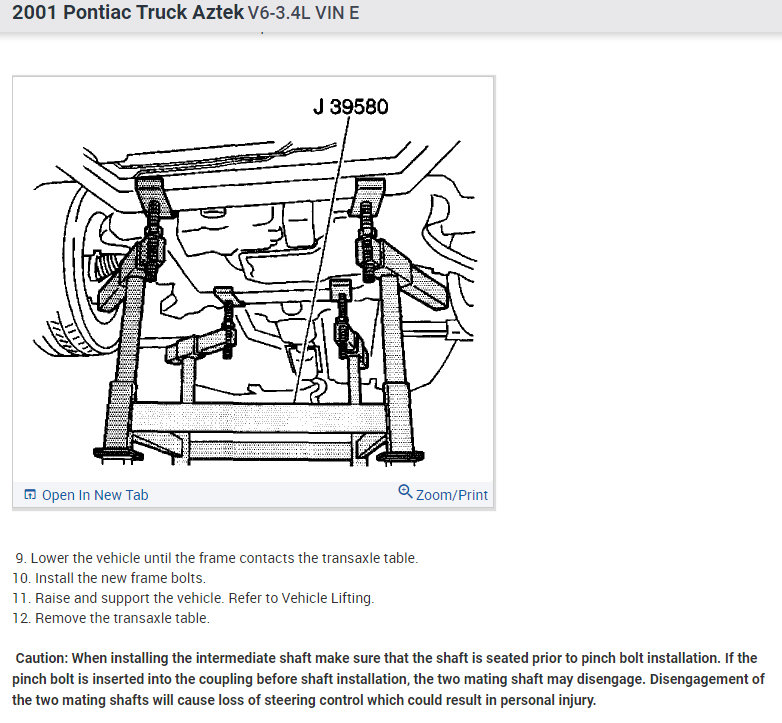

If the Grand Am is same year and has the 3.4L engine with VIN E, then yes that will fit in the Aztek.

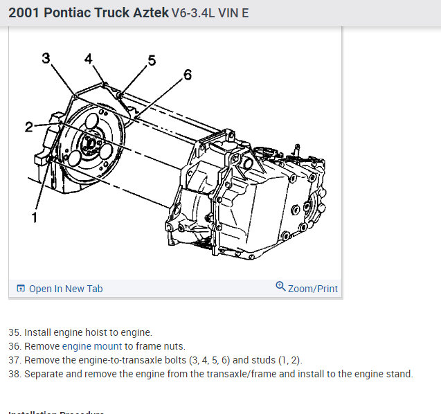

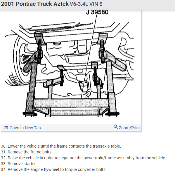

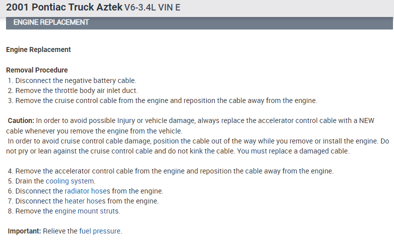

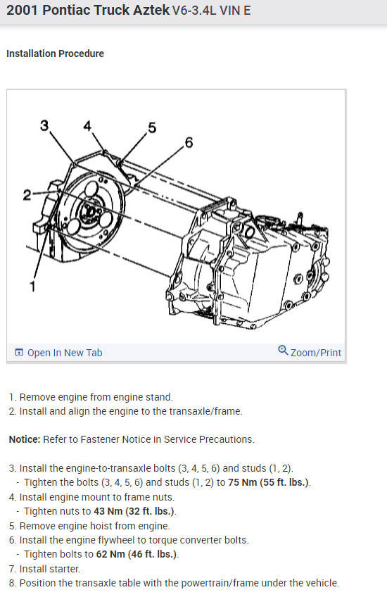

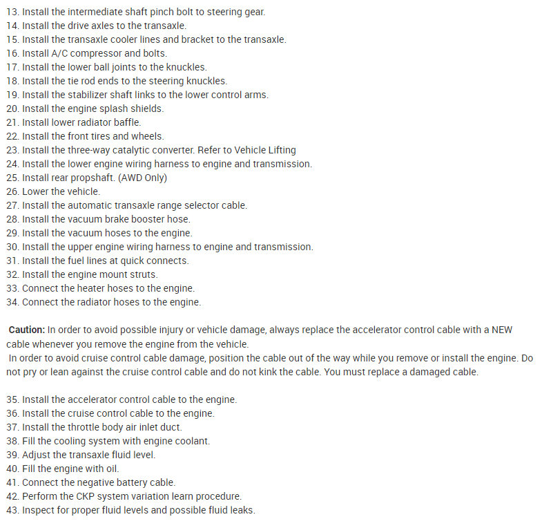

Replacing the engine is a labor intensive process and can require special tools.
You will have to start by draining all fluids, engine oil, coolant etc.
Be sure that the engine is cool before getting started.
Here is a helpful guide of engine replacement:
https://youtu.be/zy1CozLgWUQ
I have included the replacement instructions below.
