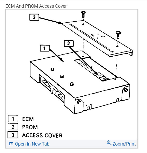

i have a 1991 pontiac 6000LE and one day it stalled on me, and we were told the fuel filter was bad so we changed it, and the fuel pump is fine, if the car sits for a few days it starts up. i had it running and then i turned off and it wouldn't start again, could something be getting to warm? i need help!
Apr 17, 2008 at 8:24 AM
SNOWWHITE225

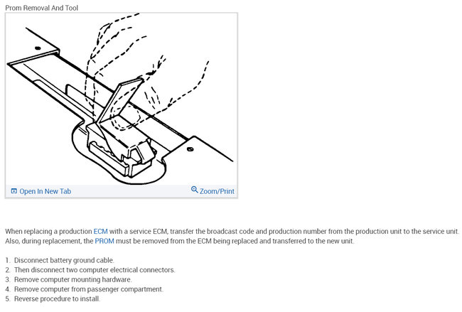

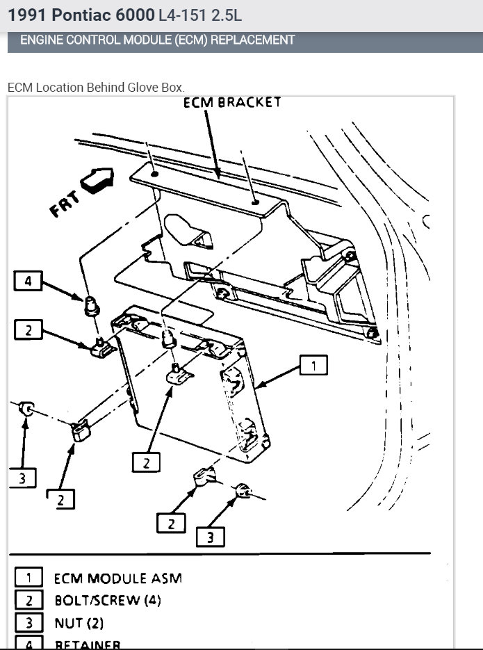

I just entered this site with the same problem it sounds like. I got a used PCM which solved the problem of the engine stalling here is the location so you can fix your car. Check out the diagrams (Below).
May 16, 2008 at 1:45 AM
