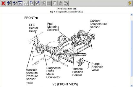

I have a 1985 Pontiac 6000 ste with multi port injection it is throwing a code 34 map sensor indicating high vacuum the problem is that i cant find the sensor

See below
https://images.2carpros.com/forum/automotive_pictures/12900_map_1.jpg
