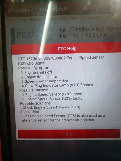

Hi all,
For the past 2 weeks my car listed above Blueline has been cranking on warm start, we have tested the car and it indicated no problems. We have replaced the petrol filter and pump, it still had the same problem. We also replaced the crankshaft sensor as well as coolant temperature sensor, still same problem with a new problem, car switches off randomly. We would appreciate any advice.

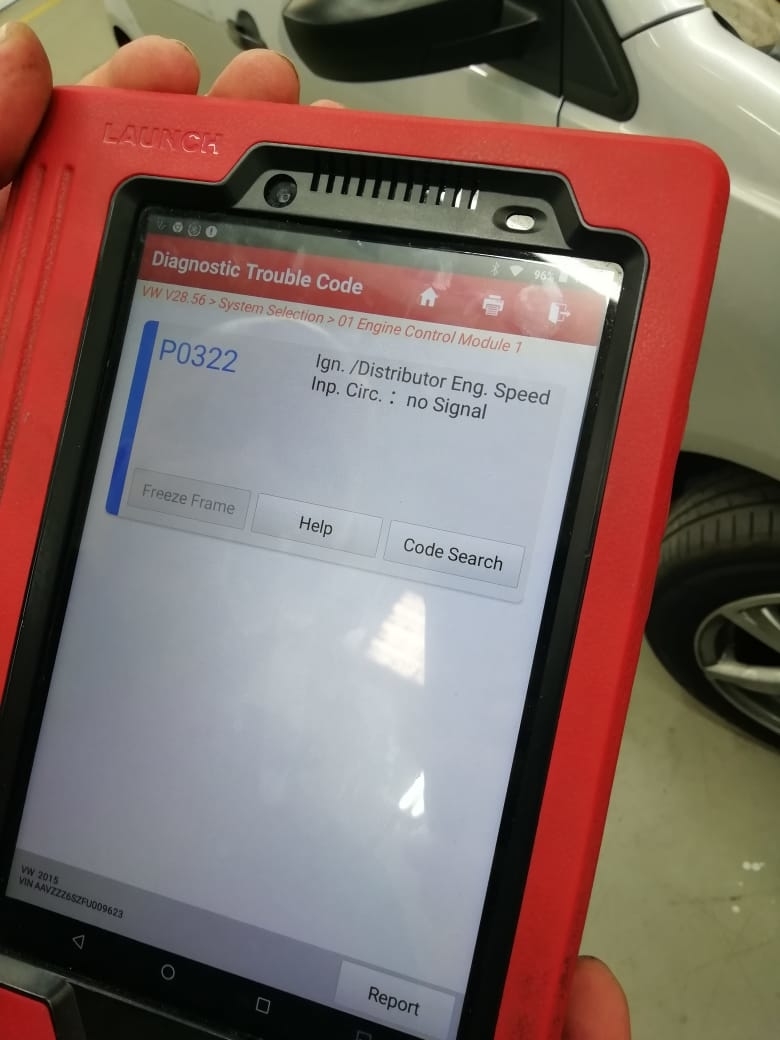

Yes that is correct.
Yesterday I did a diagnostic test and this is what it say in the pictures.
Tuesday, October 15th, 2019 AT 11:30 PM
Okay, that is saying you have no crank signal. It could be a wiring issue but most likely it is the sensor itself. If it were me, I would ohm out the wiring and then replace the sensor and go from there.

DEWALDVDW
It starts but just take long to start. Had the car on a diagnostic machine last night and it still give me that 1 fault P0322. Don't you think it can be the crank shaft pickup in the gearbox?
Wednesday, October 30th, 2019 AT 10:42 PM
Absolutely it can. Long cranks are either fuel related or crank sensor related. Basically the engine will fire without a crank sensor but it takes longer cranking because it needs to learn the engine position through the other sensors.
