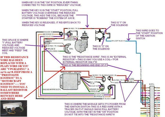

IF YOU WILL SCROLL DOWN TO "MY PICs/ DIAGRAMS" ON "FEB 5th"....IN THIS POST, YOU WILL SEE HOW I HAVE RIGGED BOTH OF MY JEEPS WITH A BALLAST RESISTOR
https://www.2carpros.com/questions/1984-jeep-cj7-84-258-i6-weber-32-36-carb-tfi-igniton-upgrade-spark-been/page/2
..........ONE, TO PROLONG POINT LIFE ON "WILLY" (1946 WILLYS)......AS MANY EARLY POINT SYSTEMS USED A BALLAST RESISTOR TO LOWER THE COIL VOLTAGE
.........DID THE SAME FOR "MR. JEEP" (1977 CJ 5) WHEN I UP-GRADED THE CRAPPY "PRESTOLITE IGNITION" (NO RESISTOR ORIGINALLY) TO THE "MOTORCRAFT IGNITION", WHICH CAME OUT IN 1979 AND WAS USED THRU 1989 ON CJs, EARLY WRANGLERS........THE MOTORCRAFT SYSTEM USED A RESISTANCE WIRE (STARTING IN '79).......I ADDED A BALLAST RESISTOR IN THE '77s REGULAR OLE WIRE TO "MIMIC" RESISTANCE WIRE FOUND IN THE '79
MAYBE I'M NOT CONFUSING YOU!
IN THE SAME ROW OF PICS---YOU WILL SEE "KEY ON" (BASICALLY BATTERY VOLTAGE 12.5 VOLTS)---A VOLTAGE READING OF "7.48 VOLTS DC"---THIS IS WHAT IT GETS REDUCED TO USING THE BALLAST RESISTOR........IT IS SLIGHTLY HIGHER WHEN IT IS RUNNING (WHEN ALTERNATOR OUTPUT 13.8-14 VOLTS)..........I THINK THE BALLAST RESISTOR KEEPS IT BELOW 9 VOLTS WHEN IT'S RUNNING....I'D HAVE TO VERIFY THIS!

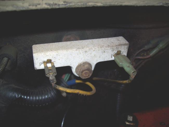

I FIGURED I COULD EITHER
A) STICK IN A COIL W/ AN INTERNAL RESISTOR..............A CHANGE FROM OEM, WHERE THE '79 USED A COIL "FOR EXTERNAL RESISTOR ONLY"
B) INSTALL THE BALLAST RESISTOR ON MY 1977...........BASICALLY "MAKE A RESISTANCE WIRE" THAT THE 1979 SYSTEM HAD ALREADY INCORPORATED INTO IT
SO I WENT WITH "B".............WHEN I NEED SOMETHING FOR MY '77's JEEP'S IGNITION.......I CALL IT A "1979" AT THE AUTO PARTS STORE..............THE BALLAST RESISTOR IS THE ONLY EXCEPTION TO THE RULE (A "MUST HAVE" TO KEEP THE REST OEM)
AS FAR AS THE BALLAST "BREAKING"---"BURNING UP"..................NO PROBLEM!...........SEEMS ANY PROBLEMS I'VE HAD WITH ONE, WAS "BOUNCING" THE JEEP AROUND, AND THE "RED HOT" COILED UP RESISTOR WIRE IN THE BACK OF THE CERAMIC GOT SHOOK HARD AND BROKE

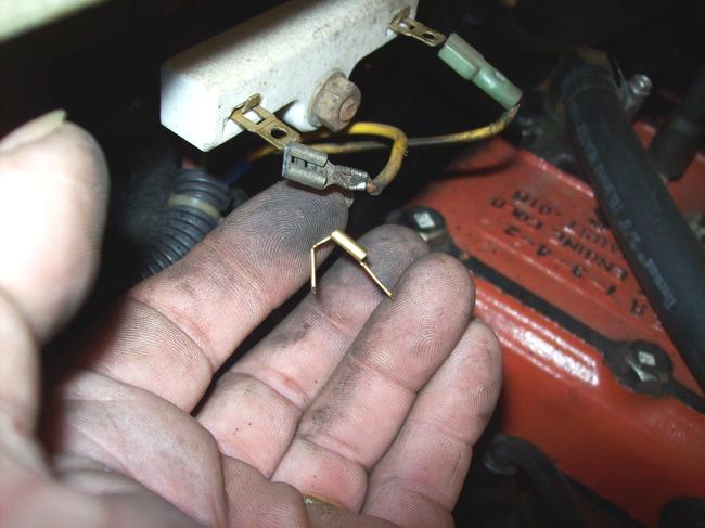

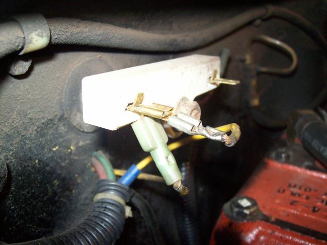

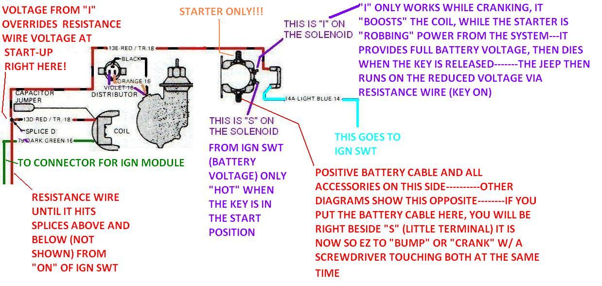

THE SYMPTOMS I'VE HAD OF THE RESISTOR BEING BAD IS-----IT'LL CRANK AND FIRE UP, AS LONG AS THE KEY IS IN THE "START POSITION" (VOLTAGE TO THE COIL IS BEING SUPPLIED BY "I TERMINAL" ON THE SOLENOID DURING "START" (FORD/ JEEP)
HOWEVER, WHEN YOU RELEASE THE KEY----IT'S NOW IN THE "ON OR RUN POSITION"----THERE IS A BREAK IN THE WIRE (THE BAD BALLAST RESISTOR) AND IT WILL NOT CONTINUE TO RUN!
IT WILL RUN (TO LIMP IT IN) SIMPLY BY BYPASSING THE RESISTOR-----THIS IS JUST TEMPORARY, TILL YOU CAN GET ANOTHER ONE------I KEEP A FEW "PIGGY BACKS" IN MY ON BOARD TOOLS AND PARTS.......I EVEN LEAVE ONE ON THE BALLAST RESISTOR, TO MAKE IT EZ!
I'M ATTEMPTING 3 PICS TO DEMONSTRATE!........FORTH IS OF THE '79 SYSTEM.......FIFTH IS SOLENOID OPERATION......SEE HOW "I" WORKS!

OK BOSS----I WENT OUT AND DID SOME MEASURING ON BOTH BALLAST RESISTORS ON BOTH OF MY JEEPS
I THEN WENT TO ADVANCEAUTOPARTS.COM AND TO AUTOZONE.COM , IN AN ATTEMPT TO FIND SOME SPECS ON THE ONES THEY HAVE.........IT'S BEEN QUITE A WHILE SINCE I GOT MINE, AND I COULD NOT LOCATE THE BOXES (I KEEP THE PART NUMBERS [LIDS OFF THE BOXES] TO MANY OF MY PARTS
I FEEL SURE THESE 2 CAME FROM ADVANCE AUTO
NEVER THE LESS, TAKE YOUR VOLTMETER IN THE STORE WITH YOU, WHERE EVER YOU GO.
I SET MY VOLTMETER TO "200 OHMS" AND WHEN IT SETTLED DOWN, I GOT A "1.7 OHM" READING ACROSS THE MALE SPADES
SORRY, I'M NOT MUCH OF AN AUTOMOTIVE ELECTRICIAN-----I JUST SORTA KNOW WHAT WORKS FOR ME. MOST OF THE RESISTORS I LOOKED AT WERE $10-$20.......I KNOW I DIDN'T GIVE ANY MORE THAN THAT FOR EITHER OF MINE!......I'M THINKING THEY WERE ON THE LOWER END OF THE PRICE SCALE!
I'M DO PRETTY DARN GOOD WITH THE JEEP CJs AND OTHER OLDER CARBURETED VEHICLES, I HOPE THIS IS SORTA HELPING YOU!
SO LIKE........WHAT THE HECK, YOU WILL BE OUT $10 IF IT DON'T WORK OUT FOR YOU!
