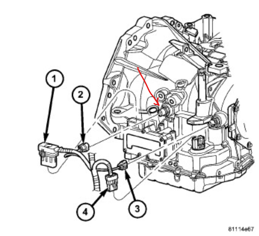

The car just started acting up after we've had monsoon rain here in Oklahoma been parked the whole time out of the rain check engine light came on and will not shift out of 1st not even using the manual slap stick. Can someone please help me? I've never had a problem with this car until now. had it a year got it used.

So this code comes up when the transmission fluid is low or needs service, also the input shaft speed sensor can be bad as well.
P0731 - Gear 1 Incorrect Ratio

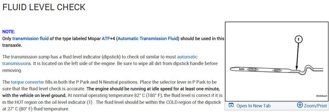

I would start by checking the fluid level, here is a guide to help you and instructions below for your car:
https://www.2carpros.com/articles/how-to-check-and-add-transmission-fluid
Next, I would swap out the input shaft sensor with a new part. The transmission may have an internal problem, but we should do the easy stuff first. Check out the images (below). Let us know how it goes.

input shaft speed sensor is this expensive, I checked the transmission fluid it registers on dip stick so I'm guessing it's a bad sensor is this typical for 65,000?

Hi Ken, okay, if I'm sitting in the driver seat looking out of the windshield what side would the sensor be on? I only ask this because I've never worked on a transmission for four cylinder the engine sits in the up under the hood sideways but I'm not sure how the transmission itself sits under the car that's why I'm asking and when I locate this input shaft sensor when I go to replace it will any transmission fluid come out so should I have some oil Rags with me or when I take it out will nothing come out I don't know because I've never worked on one I'm just asking.
May 10, 2025 at 5:32 AM
  • 55,402 POSTS
If you check out the image above it shows the sensor on the left side of the transmission, so that would be near the radiator. Transmission fluid will no spill out so no worries there. If you have troubles let me know so I can help walk you through the repair.

Hi, crawled up under the journey and saw a sensor on there behind all the air duct on side of transmission between engine and radiator hoping I found the right one wondering if I found the right one, and please don't tell me when starter goes out the transmission has to be dropped if I think that the case looks like it's inside trans housing.
May 21, 2025 at 1:36 AM
  • 55,402 POSTS
The sensor is outside the housing, please recheck the images above.
