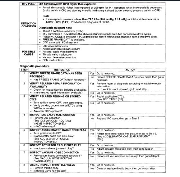

Surges at idle and cruise speed.
Feb 27, 2020 at 2:34 AM
Experienced Mechanic
52,796 POSTS
Good afternoon,
I attached a flow chart for the code. It is for high idle. It could be the idle air control or the throttle body but needs to be confirmed.

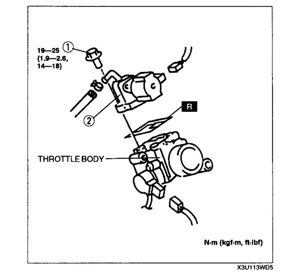

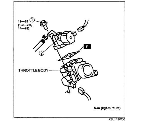

Okay, I attached a picture of the idle air control for you. This is a very common failure for idle surging.
I would also clean the throttle body of all carbon as well. I attached a guide for you to follow for the cleaning process.
Let us know if you have any other questions.
