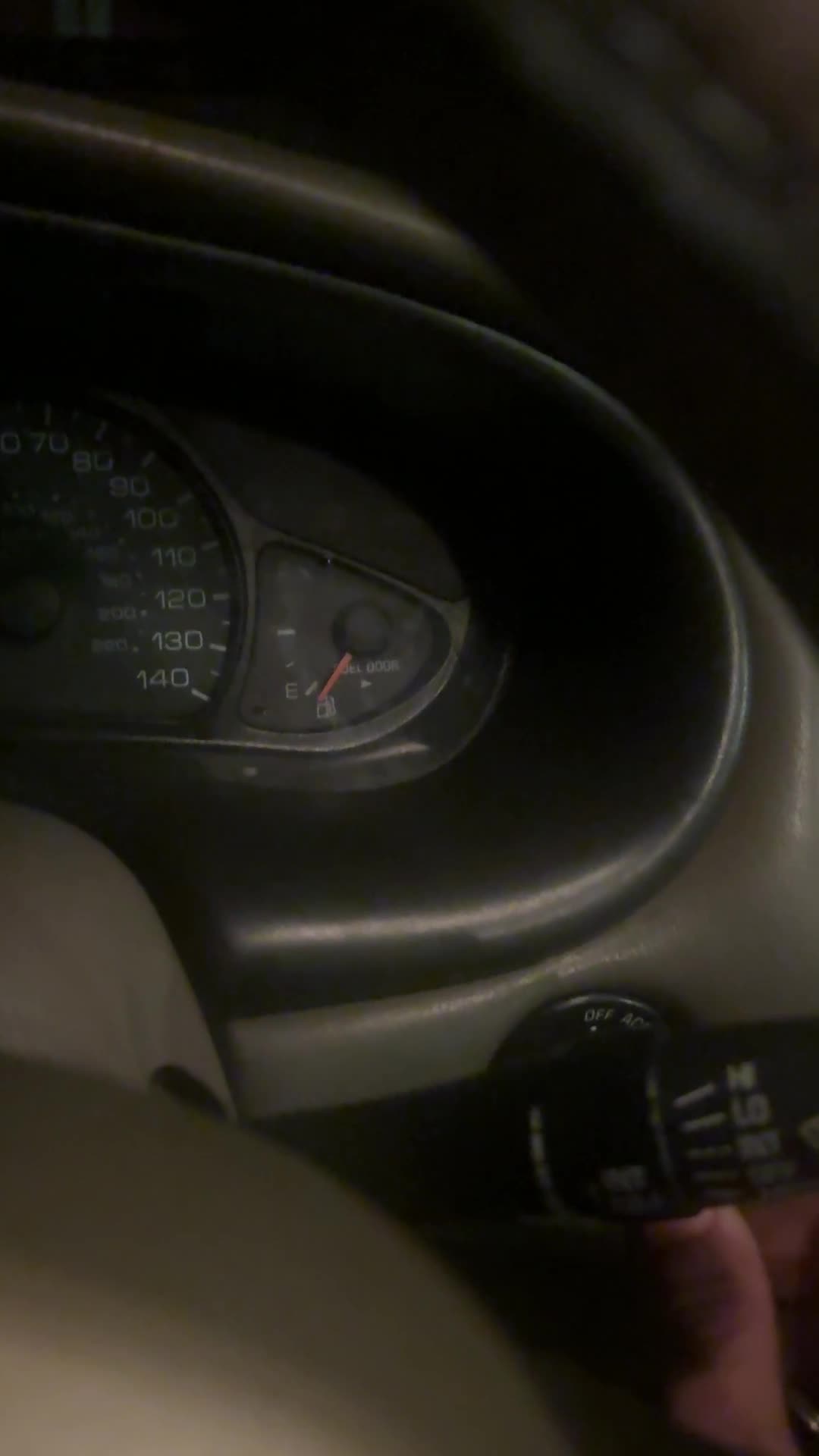

I have a video of what my gas gauge is doing. I have tried a new harness and fuel level sending unit. The PCM had a short in it causing it not to function but now it does but shoots to full and then drops down to E after. I think it’s a defective part

To me it looks like the gauge is bad or you have a open connection.

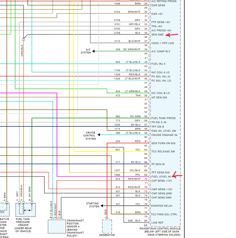

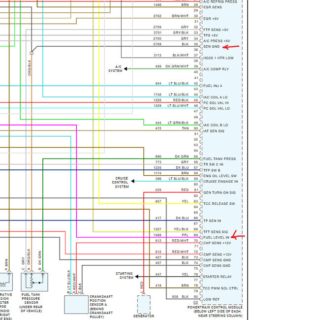

P0463 means the PCM is seeing the fuel-level-sensor signal voltage too high.

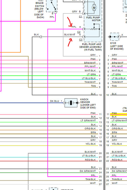

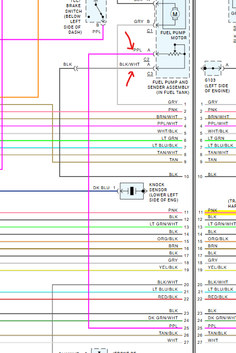

So this can be the PCM is bad because the signal goes through the PCM but we should run some tests first. Lets do a continuity test for the two wires that control the fuel gauge first. Here is a guide to help.
https://www.2carpros.com/articles/how-to-check-wiring/
Here are the wires to test. Check out the images (below). Let me know how it goes.
