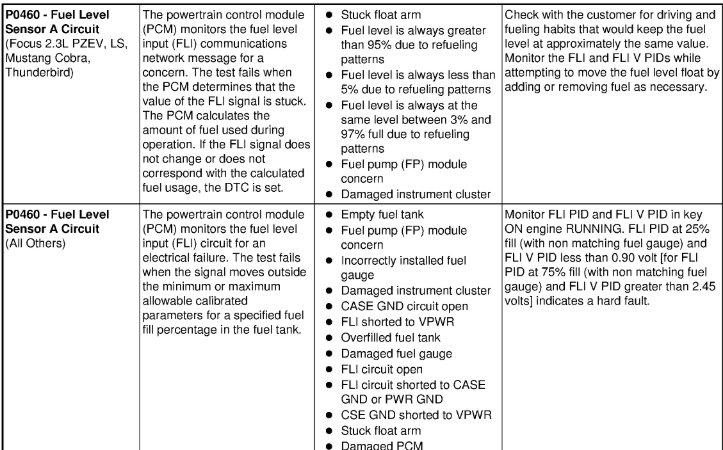

Changed fuel pump assembly with new one today. Now getting a PO460 code and low fuel light on. Any suggestions to try before dropping tank again?

Are you certain all the connections are secure? I've attached a picture of a few things to check below.. Hope this helps and thanks for using 2CarPros.

Turns out the new fuel pump was bad. Replaced it with another one and everything is working fine again!
