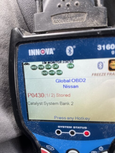

Drivers side, I checked out the oxygen sensor just before the exhaust exits the converter it reads .4-.5. and bank 2. I suspect it’s the converter what’s your opinion?Also I called and researched Magnaflow converters they do not make a direct fit. Any suggestions on a good aftermarket converter? Thanks for your help.
Nov 21, 2022 at 12:47 AM
  • 110,248 POSTS
Chances are, you are correct. The code is specific to the bank 2 converter. By chance, do you have a scan tool that can communicate and actuate different circuits? I attached the diagnostics below if you do.
If you don't have a scan tool that can do this, try deleting the code and see if it comes back. If it does, suspect the converter is the issue.

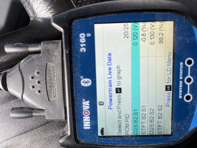

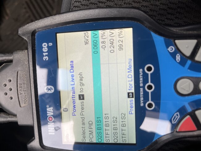

Hello Joe, these are the voltages I read with my meter 0.14 volts (006 ohms) before the cat and .07 volts (0.10 ohms) after the cat. Also, I applied gasket cement when I replaced the intake manifold gasket.
Also, I just wanted to send you a picture of some of the reading I read. Thanks Joe really appreciate your help.
Nov 27, 2022 at 10:22 PM
  • 110,248 POSTS
Okay, that is odd. Bank 1 Sensor 1 indicates a -8% which is telling the computer to remove fuel from the mixture. However, sensor 2 is showing +99% which it telling the computer to add a ton of fuel. Normal readings are between -10% and +10%. Sensor 1 is fine, sensor 2 is crazy.
I suspect sensor 2 has failed or we have a PCM issue. Have you tried replacing the sensor?

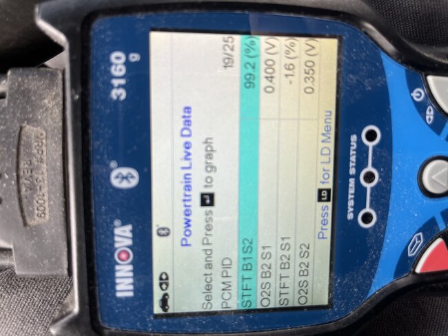

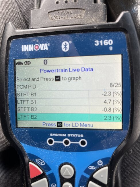

Hello Joe, it’s been a while. I hope all is well with you. I replaced bank 1 sensor 2 and these are the readings. Also still getting PO430 bank 2.
Dec 16, 2022 at 1:35 AM
  • 110,248 POSTS
Based on what I am seeing, the bank 2 catalytic converter is failing. The sensor readings are where they should be.
