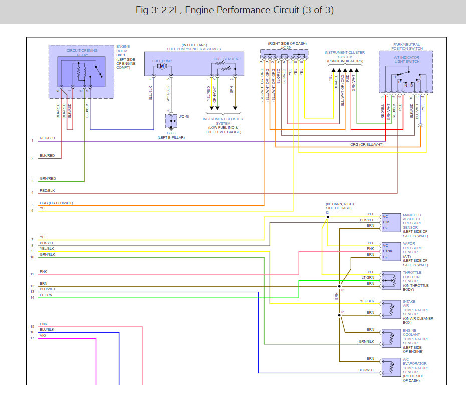

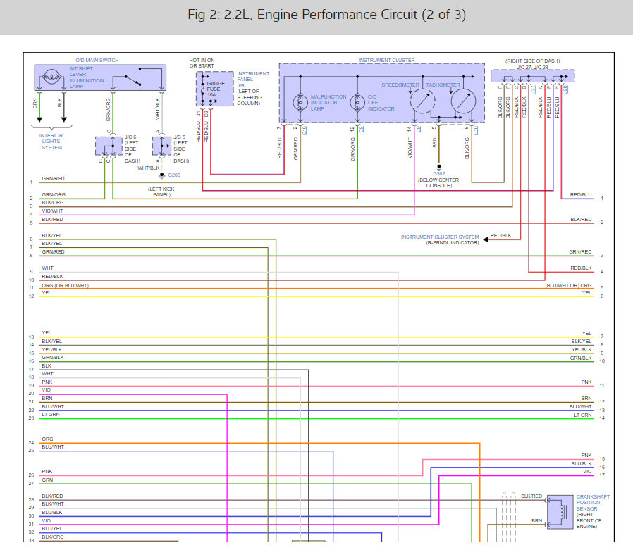

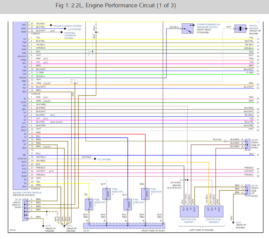

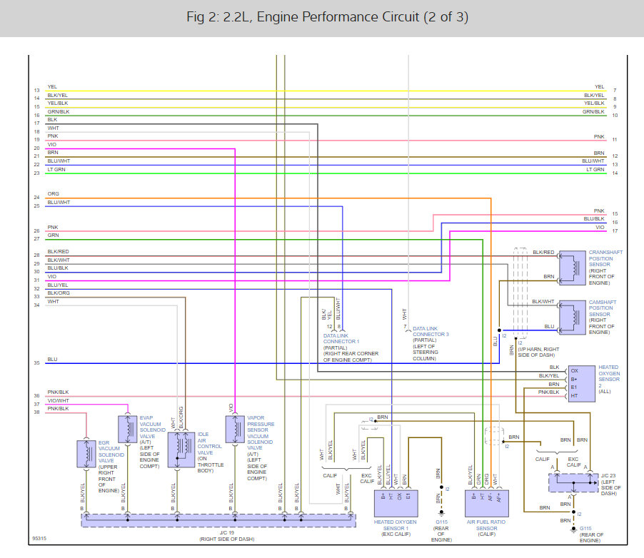

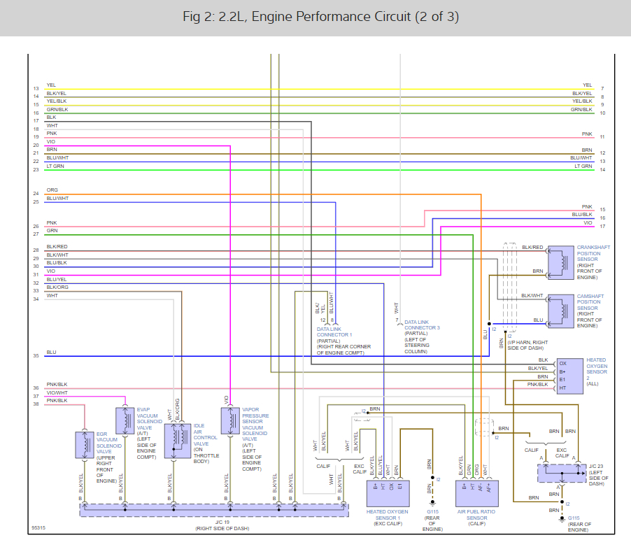

When the battery is disconnected the code doesn't come up for about five seconds but when you leave it connected and restart it automatically shows. I changed the camshaft sensor, but the code remains lit. What else can I do? How do you check the wiring to eliminate the PCM?
Oct 16, 2022 at 4:39 AM
  • 55,433 POSTS
Sure, here is a guide to help you check the wiring and I have included the engine and camshaft wiring diagrams so you can see how the system works and which wires to test.
Check out the images (below). Please let us know what you find. We are interested to see what it is.
