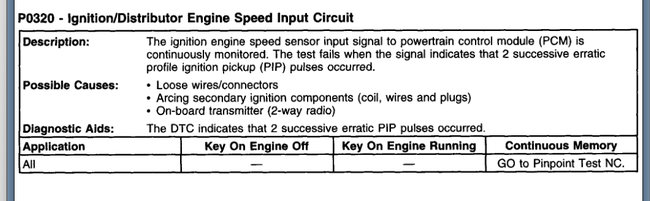

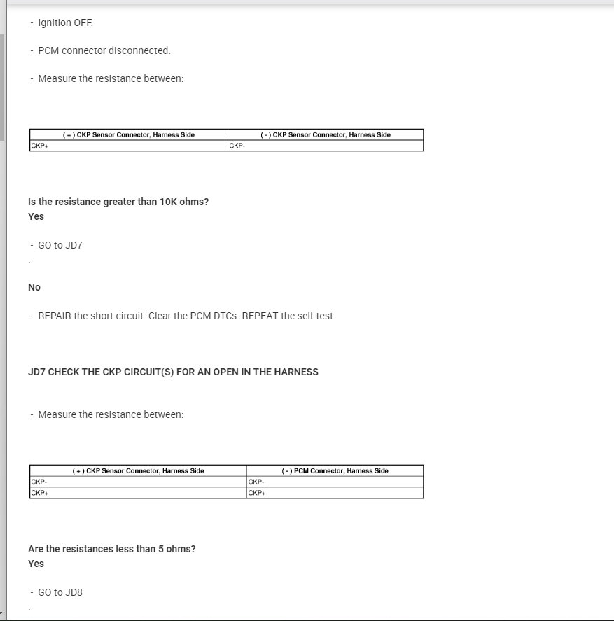

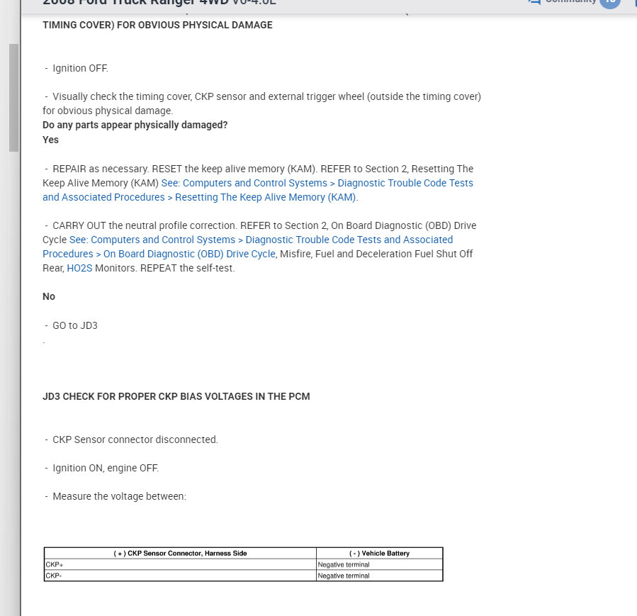

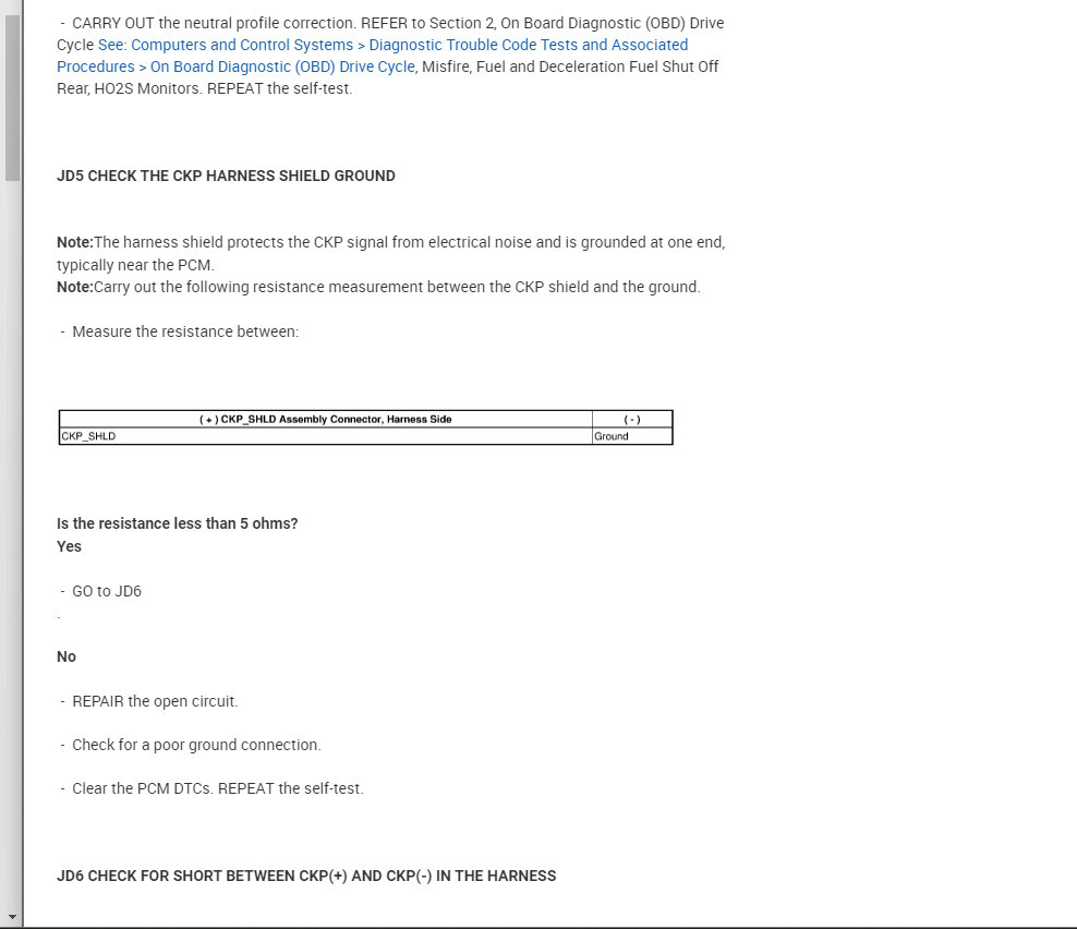

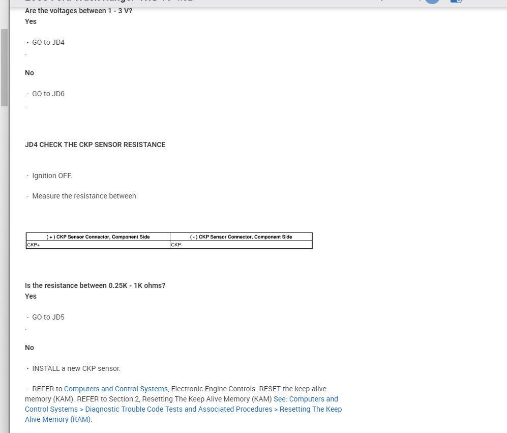

This code is basically telling you that the PCM is not getting the proper signal from the crank sensor. So that means this could be a sensor but if you just replaced the time chain then I suspect we have an issue with this repair still.
https://www.2carpros.com/articles/serpentine-belt-timing-belt-timing-chain-diagrams

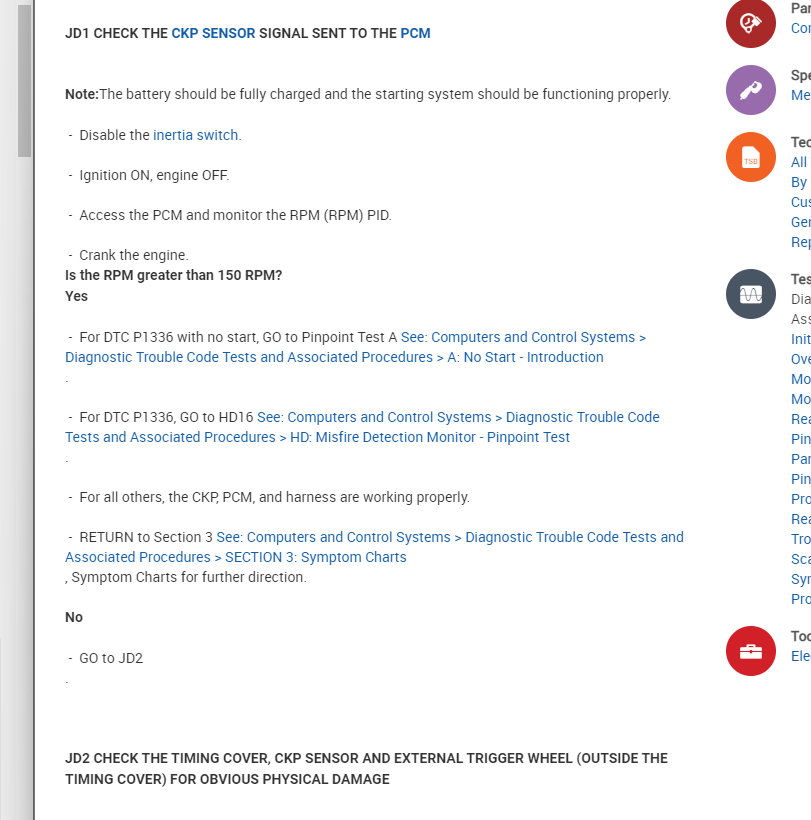

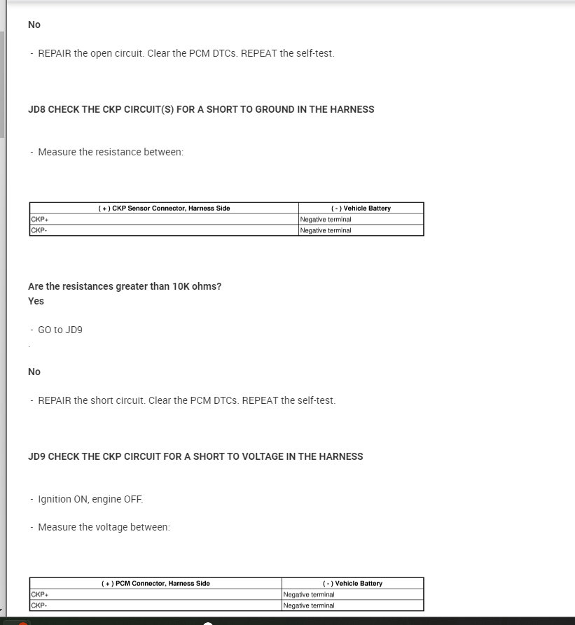

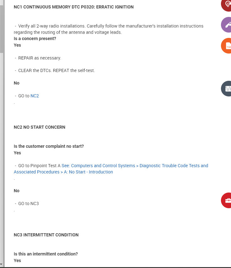

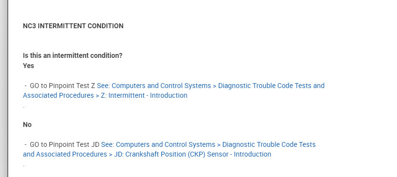

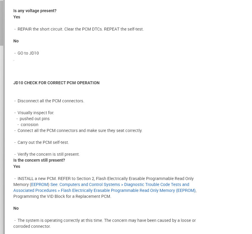

Unfortunately, the only way we are going to know is to run through the testing that we have for this code as something could have happened during the repair. So basically, we need to go off, what this is telling us the issue is which at this point is the P0320 code.
So, let's run through the testing below and let me know what you find or questions.
Thanks
