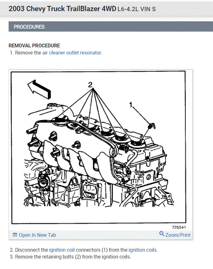

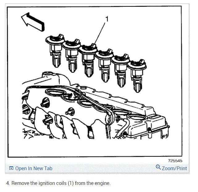

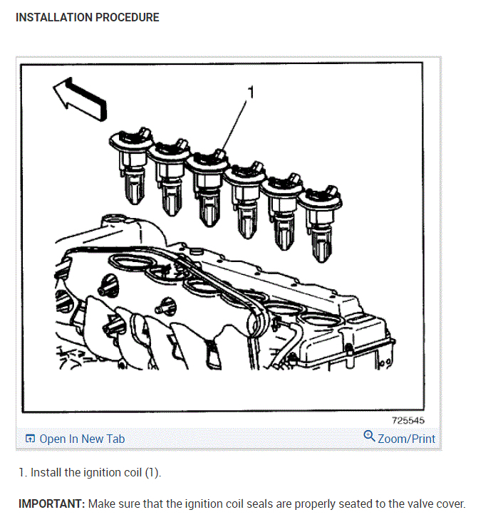

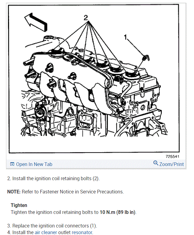

A misfire can be caused by several different things. In this case, the first thing I would do is remove the spark plug, inspect its condition, and see if there is a spark to it.
If you remove the plug, take a pic of the end of it and upload it for me to see. Also, if the plug is good, I want you to switch the coil from cylinder 1 to a different one. Then see if the misfire changes location.
Here is a link that shows how to check for spark to the plugs:
If you look below, I included the removal and replacement of the ignition coils. You will only need to remove cylinder 1 to do the check.
Once the coil is unbolted and removed, the spark plug is down in the spark plug tube. Remove it and inspect. Actually, you may want to replace all the plugs if they haven't been done for some time.
Let me know what you find.

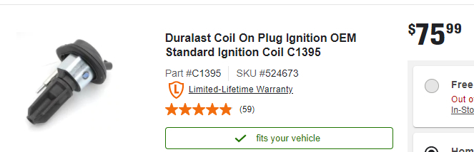

Yes, the cylinder change to cylinder 2. so what does that mean?
Jul 31, 2021 at 6:45 PM
DANNY L
  • 5,648 POSTS
Hello, I'm Danny.
You were asked to switch the cylinder #1 coil to a different location. By doing this you just determined you switched the misfire to cylinder #2 now. This just means we now know the ignition coil you moved is the defective component causing the problem. I've attached a picture below of the ignition coil from the AutoZone website with the price and part number. All you need to do now is purchase a new ignition coil and replace the one you switched. Let us know if you have any further questions on this issue. Hope this helps and thanks for using 2CarPros.
