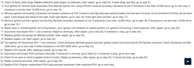

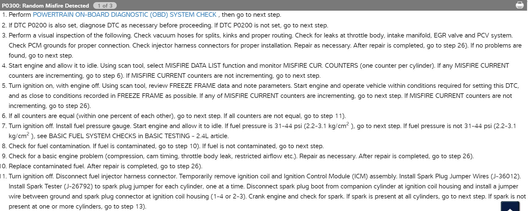

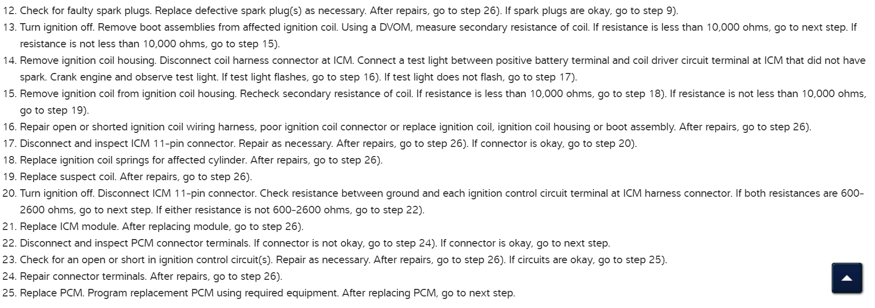

I'm adding some guides to help as well as the Diagnostic Procedure. But I would check the Converter first.
