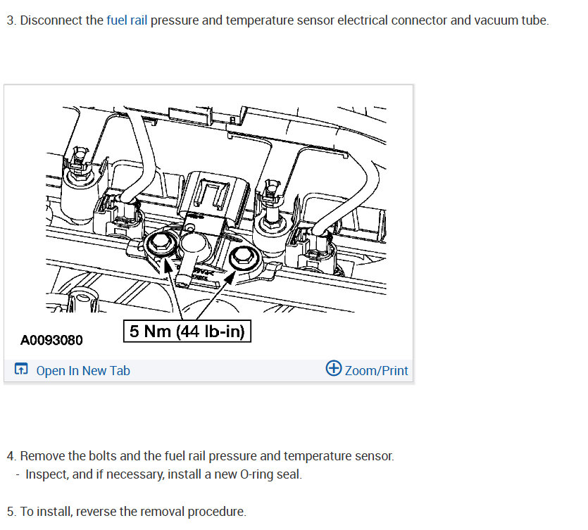

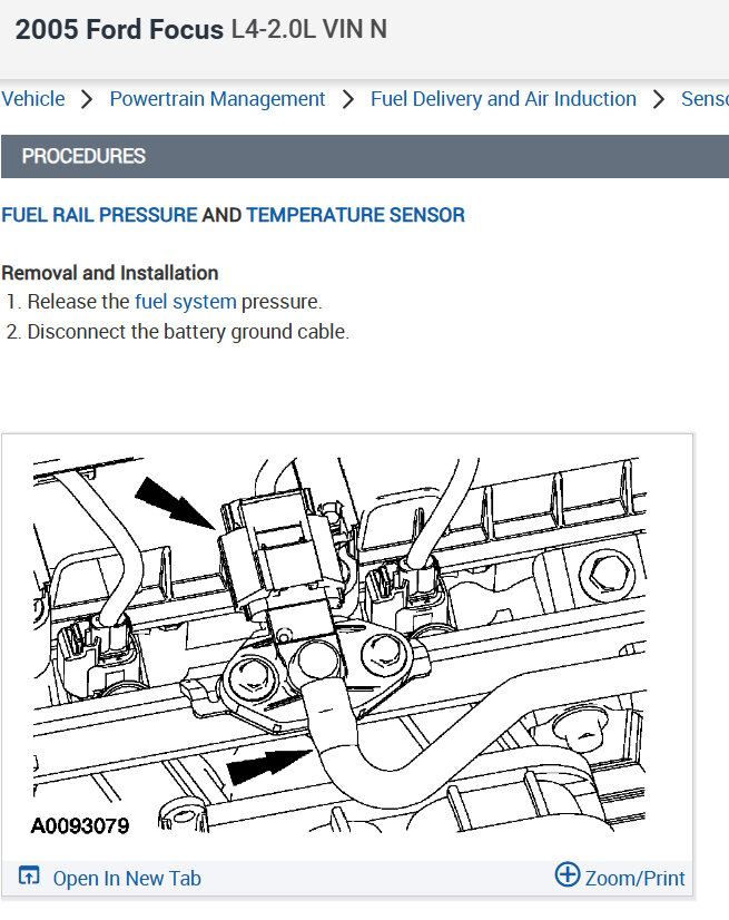

Where is this fuel temperature sensor located?
Oct 29, 2024 at 4:56 AM
  • 55,711 POSTS
So the fuel temperature sensor is integrated into the fuel pressure sensor.
The P0182 code on a 2005 Ford Focus refers to an issue with the Fuel Temperature Sensor A Circuit Low Input.
Here is a video to show you how to change it out:
https://www.youtube.com/watch?v=A9dbXbydGro
I included more information in the images below. Check out the images (below). Let us know if you need anything else.
