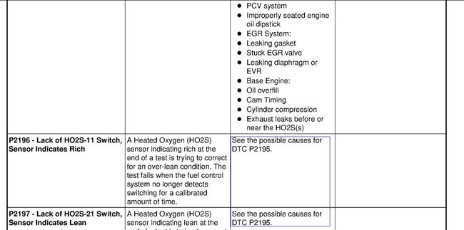

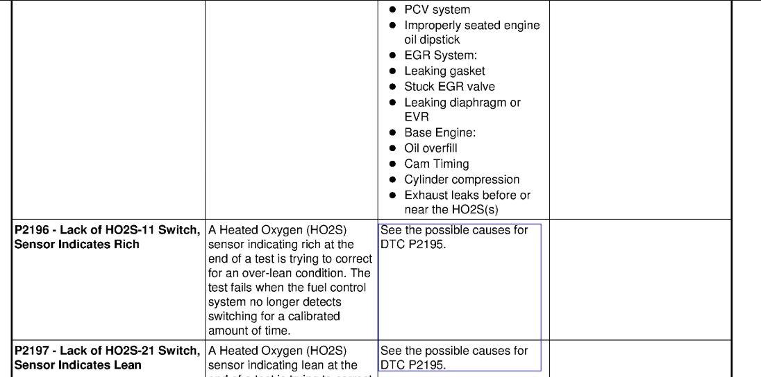

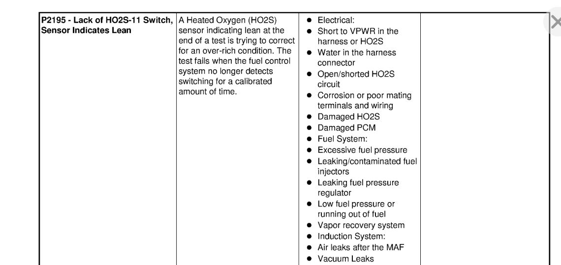

Follow up: i have done the vacuum check, except for the vacuum gauge. I don't have that tool. So far there seems to be no leaks. My A/C is blowing hot in the front, but not in the rear passenger compartment of limo. Not sure if that is related? I'm hoping it just needs to be recharged. I'll be recharging A/C, and checking fuel pressure these next few days. Also, have a new code come up p2195? Any ideas?
Feb 17, 2020 at 10:55 PM
Good morning.
Just to reinforce Joe's replies, I agree that you may have low fuel pressure causing the codes. Very common for this issue.
2195 is a lean indication also connected to the other codes.

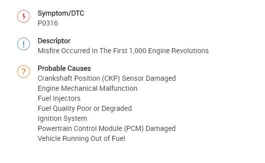

Update 2: Took Limo out on run last night, after about 30 minutes of idle time it started back up.. car vibrating, motor shaking like it wanted to stall. After 2 hours took her back home, (It took 5 minutes before car engaged and drove normal). Checked codes and got the same PO171, 174, 300, 305, 316, P2195. Haven't a clue what 316 is? I will do a complete smoke vacuum check next week!
Feb 21, 2020 at 3:14 PM
316 is a misfire during the first 1000 engine RPM.
In most cases, it is the number 6 ignition coil failure.
