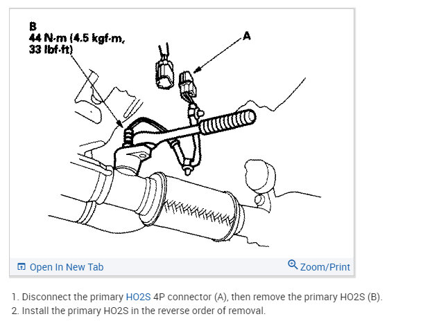

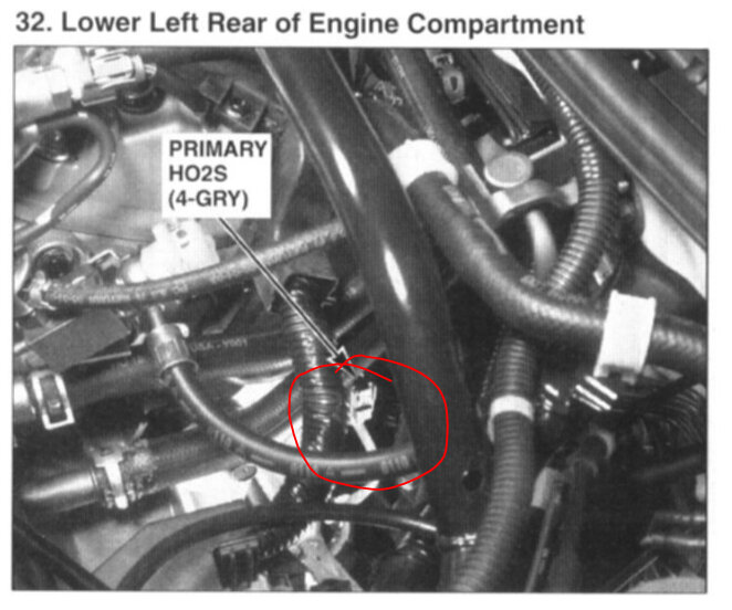

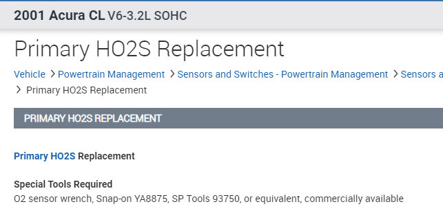

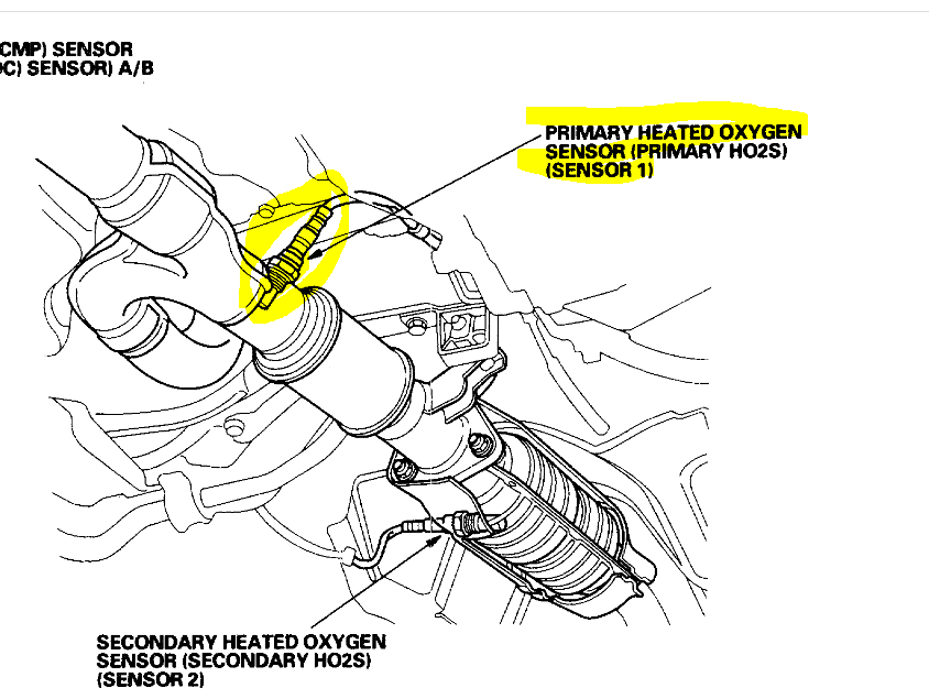

The primary sensor is on the left side of the engine. If you look below, pics 1 and 2 show the location. The last two pics provide the directions for replacement.
Let me know if there is anything I can do to help and if this is what you needed. Also, you will need a socket designed for sensor removal on your vehicle. Most parts stores will lend one to you.
