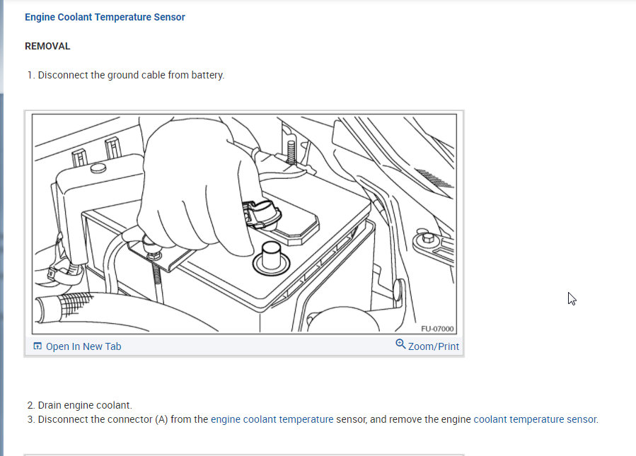

I need to replace the coolant sensor.
Apr 8, 2019 at 10:06 PM

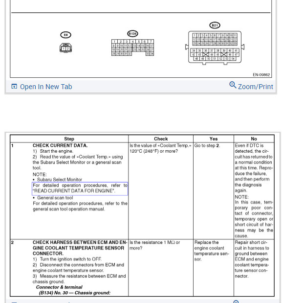

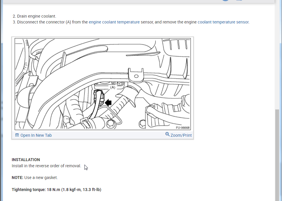

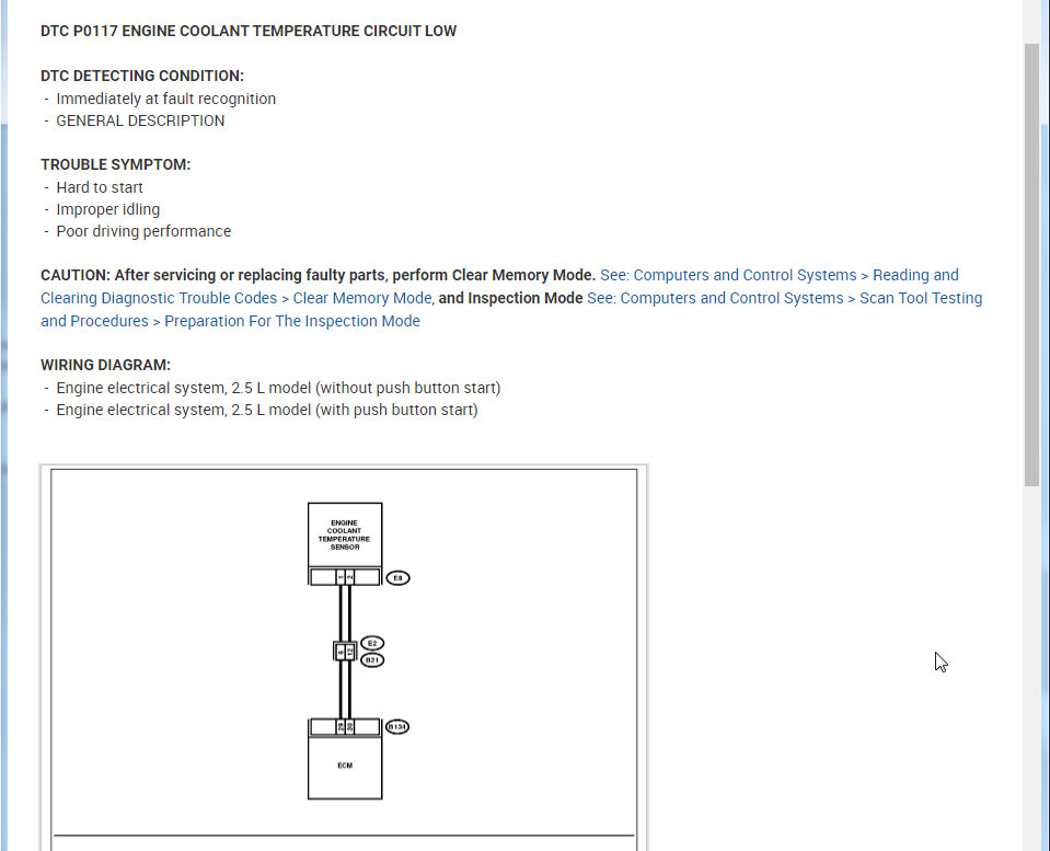

Below you will find the process to replace the sensor as well as the testing for this code.
Most of the time it is the sensor but if not then we can run through the testing to find out what the issue is.
Please let us know if you need other info. Thanks
