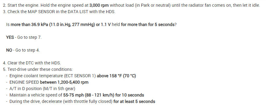

Hello, so, I have the car listed above LX, with a code Po1129-Map higher than expected, the RPMs are between 2,000-3,000 when car starts and also when accelerating, it runs rough, when the A/C is turn on it wants to stall out. All ignition coils, spark plugs, PCV, EGR valve where replace this week and throttle body was clean has well.

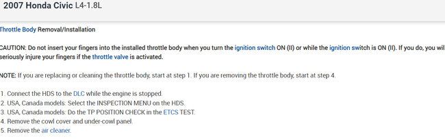

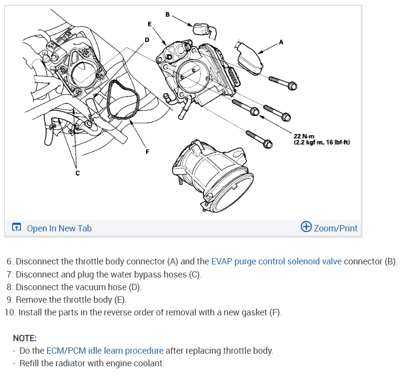

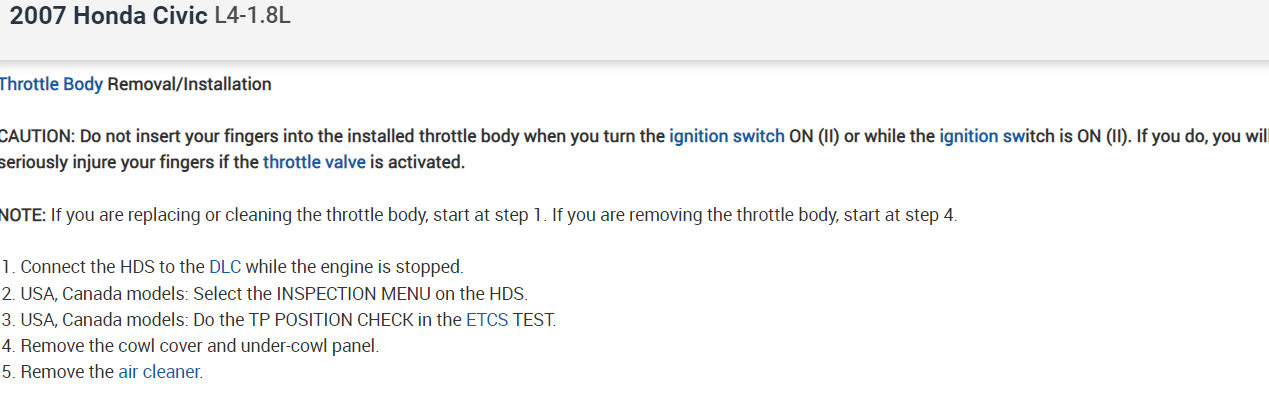

And this guide can help with the throttle body service with instructions below to help you with your car.

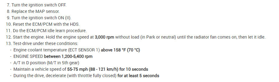

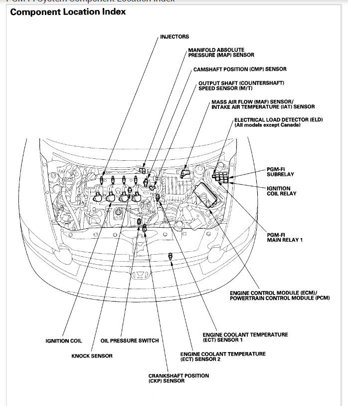

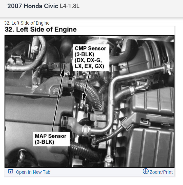

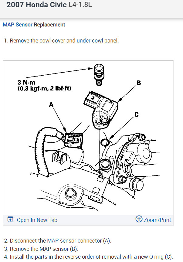

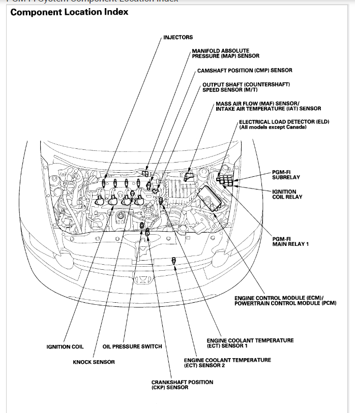

If none of these work, I would try swapping out the MAP sensor which I have included the location for as well. Clear the codes once you are done. Check out the images (below). Please upload pictures or videos in your response of any problems so we can see what to help you with.

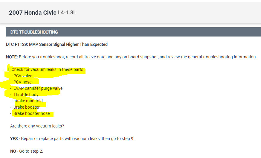

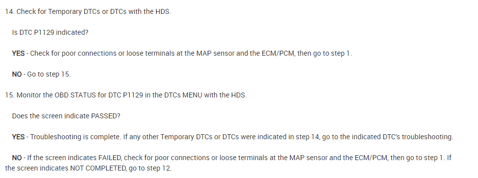

The code indicates the MAP (manifold absolute pressure sensor) signal is higher than it should be. There are a few things that can cause this code.

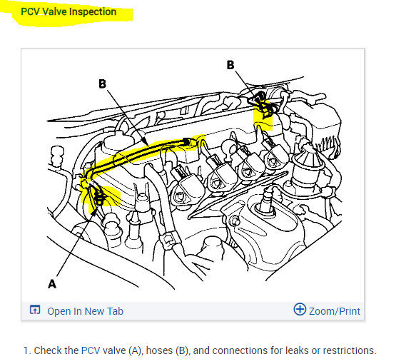

First, make sure there are no engine vacuum leaks. Specifically check the PCV hose to make sure it is connected and not cracked and leaking.

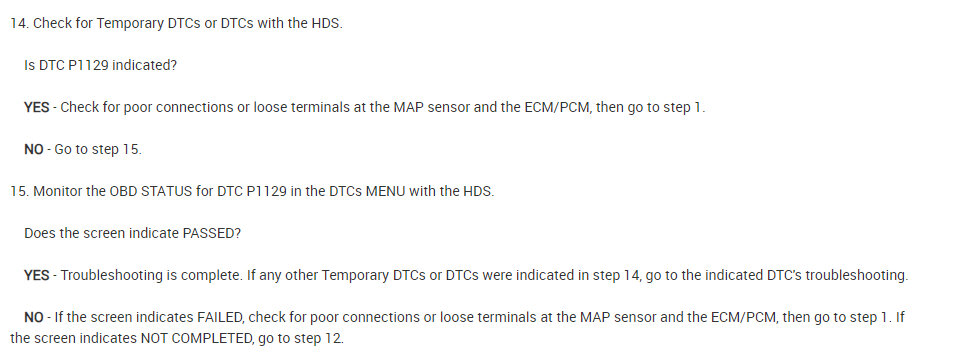

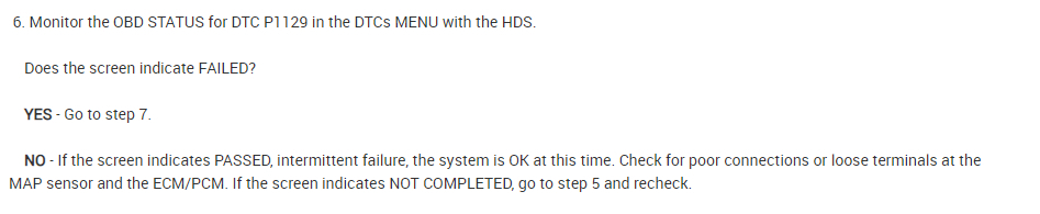

If that checks out good, then we need to jump into some diagnostics. I attached them below. Note, they diagnostics indicate the need for a scan tool that can communicate with the vehicle.
Take a look through the diagnostics and let me know if you have questions or if you feel comfortable performing them. If not or if you don't have the scan tool, you may want to consider replacing the MAP sensor. It could have failed.

Also, I attached a picture below (last pic) showing the PCV and PCV hose. Make sure it isn't broken.

I appreciate your reply, I was able to find the problem. The issue was the Map sensor itself was going bad. so, I replaced MAP sensor and also replaced PCV hose it was crack. now car runs better, but another code popped up.
