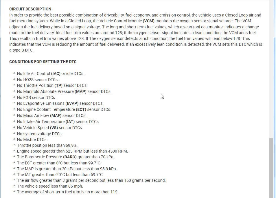

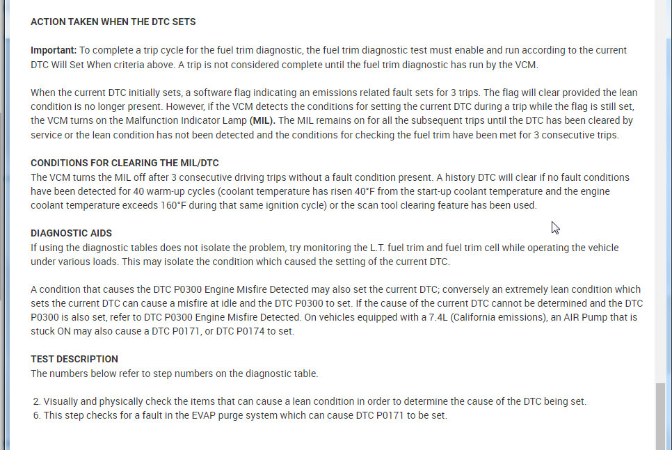

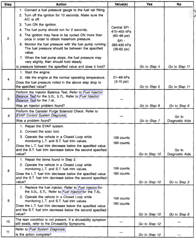

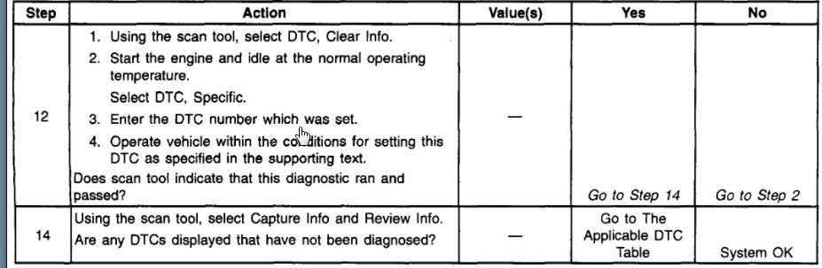

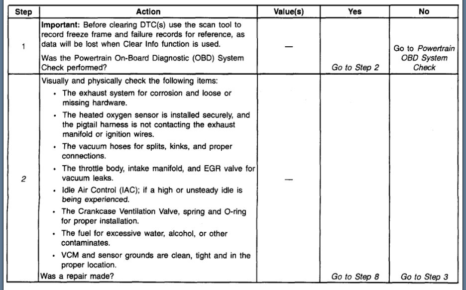

The only issue I have is if the leak was found before the air flow sensor then it would not effect the engine to cause this code. Here is a guide that will help with this:
https://www.2carpros.com/articles/repair-lean-mixture-codes-p0171-or-p0174-on-some-manufacturers
Take a look at this info below on this code and that will help figure this out.
Also, here is a guide that will give a different way to test for a vacuum leak. Using the starter fluid method as shown is a more effective way just because it tells us when there is a leak and it effects the RPM, then that tells us it is changing the air/fuel ratio.
Let me know if you have questions. Thanks
