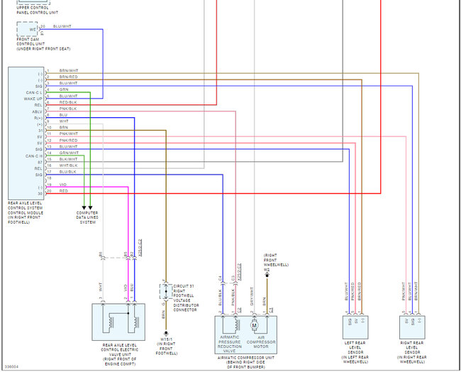

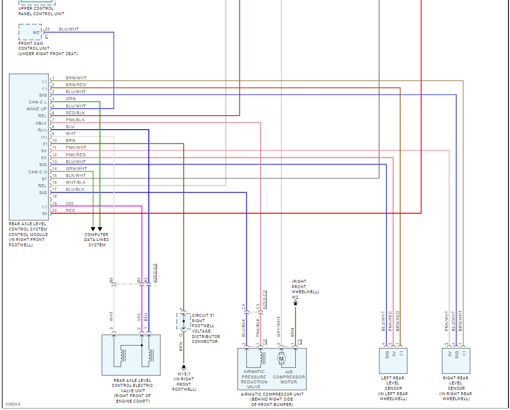

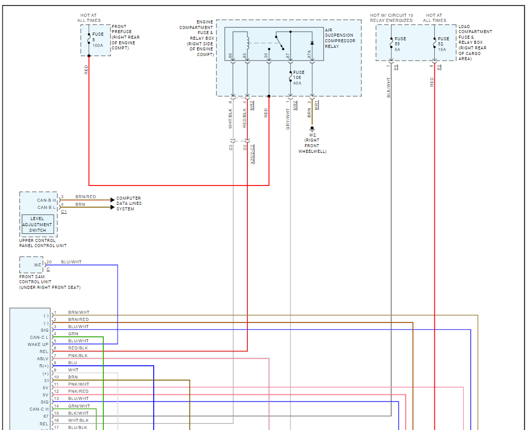

The compressor of the rear suspension Is not functioning. I have scanned the vehicle but no code. Please could I get the wire diagram for the compressor.
Apr 18, 2024 at 1:02 AM
  • 55,721 POSTS
Usually this will be a compressor failure or the control relay FYI. Here are the wiring diagrams for the rear suspension compressor circuit. Check out the images (below). Let us know how it goes.
