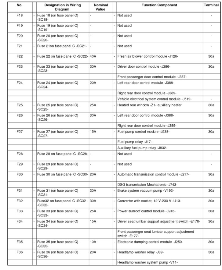

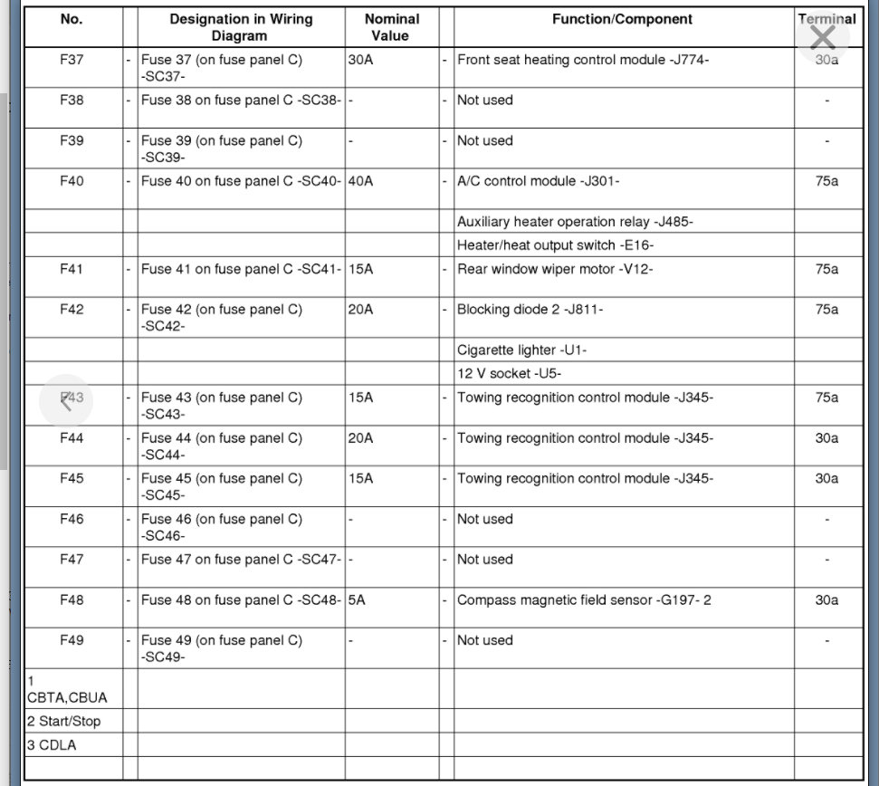

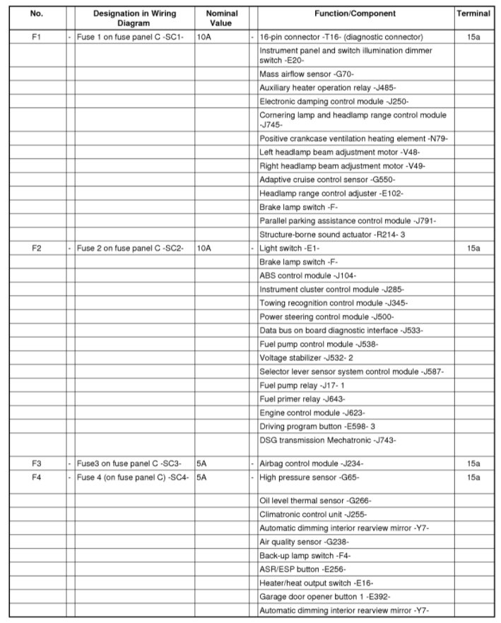

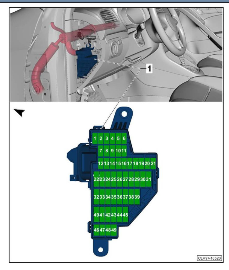

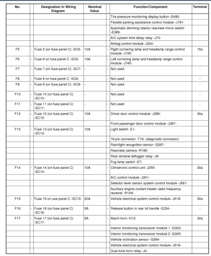

I changed the solenoid and clutch and it still behaves the same way. I need to check the fuses where is the panel and what do the fuses do too?
Nov 28, 2019 at 5:51 AM
Here is a guide that will help with testing and replacing fuses:
Below is the info from the manual on these fuses and the locations. Please run through this info and let us know if you have any other questions. Thanks
