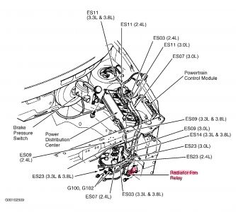

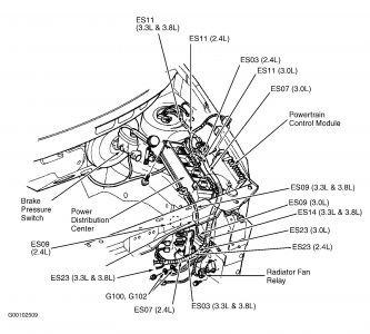

I have a 99 plymouth voyager 3.3L , I need to install relay for radiator but I can't find it . Can anyone tell me where exactly it is? thank you

I asume you are talking about the radiator fan relay? here is a diagram of location of relay
https://images.2carpros.com/forum/automotive_pictures/54223_plymouth_voyager_fan_relay_1.jpg

Front of left frame rail.
https://images.2carpros.com/forum/automotive_pictures/62217_FanRelay_copy_1.jpg
https://images.2carpros.com/forum/automotive_pictures/62217_30961_mitchell_2_25.jpg
