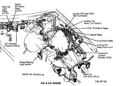

The radiator fan wont turn on so I got a relay switch
in hopes of solving the problem but dont know where it goes? THere are 7 relays under the hood, which is the right one to replace? HELP !

When you open the drain it leaks throw that small hose
Check and make sure the drain is seated all the way and it’s not missing a gasket
As for the relay location I’ll send you the diagram 4 it
Check u r coolant level and check fan switch
And fan motor
Good luck
https://www.2carpros.com/forum/automotive_pictures/99387_93_voy_1.jpg
