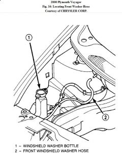

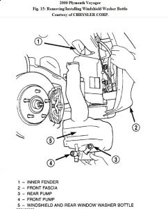

doesn't squirt onto the windshield. I'm not sure where the pump is. Maybe it's below the fluid container. I'm not sure how to get that out. Do I need to come up from below the container? I think if I can get to the pump I can resolve the problem.
Thanks

Hi dismas, Thank you for the donation. Here are procedures for removing the windshield washer tank with motor. WINDSHIELD WASHER BOTTLE Removal & Installation 1 . Disconnect and isolate the negative battery cable. 2 . Suitably support vehicle on safety stands. 3 . Remove right front wheel. 4 . Remove front wheelhouse splash shield. 5 . Disconnect connectors from the front windshield and rear window washer pumps, the fluid level sensor, and the rear washer hose. See Fig. 15 . 6 . If washer bottle has fluid in it place a suitable drain pan under the hose connections. 7 . Disconnect front washer hose at front wiper unit in the engine compartment. See Fig. 16 . 8 . The front hose will be removed with the bottle. Allow washer bottle to drain. 9 . Remove screws holding washer bottle to front fender support and remove bottle. 10 . To install, reverse removal procedures.
