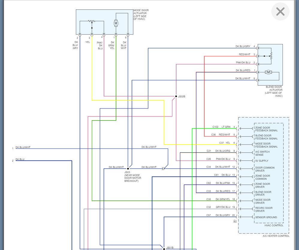

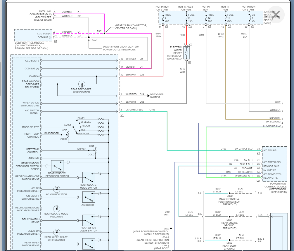

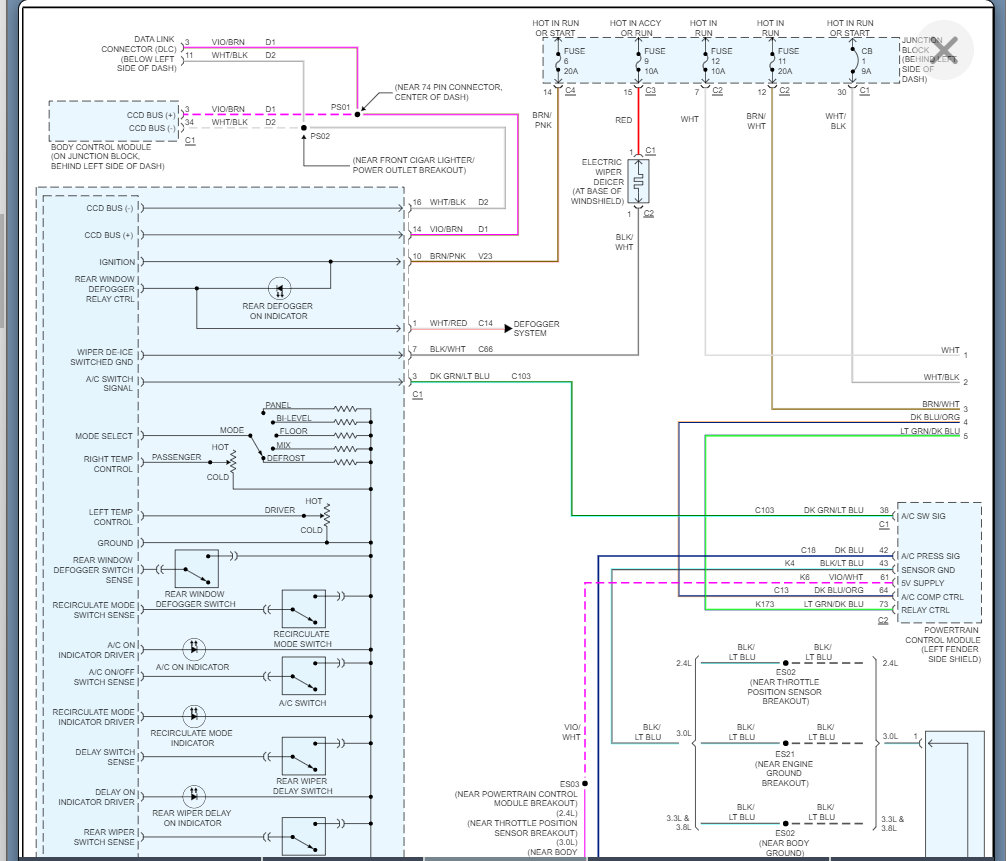

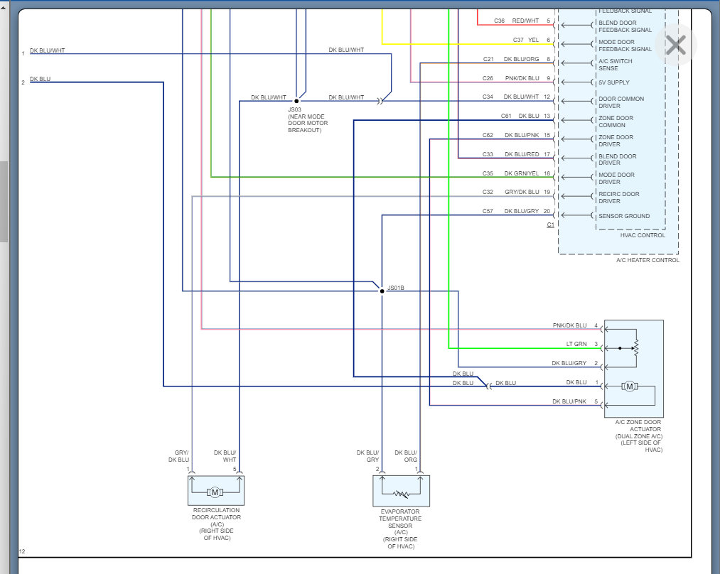

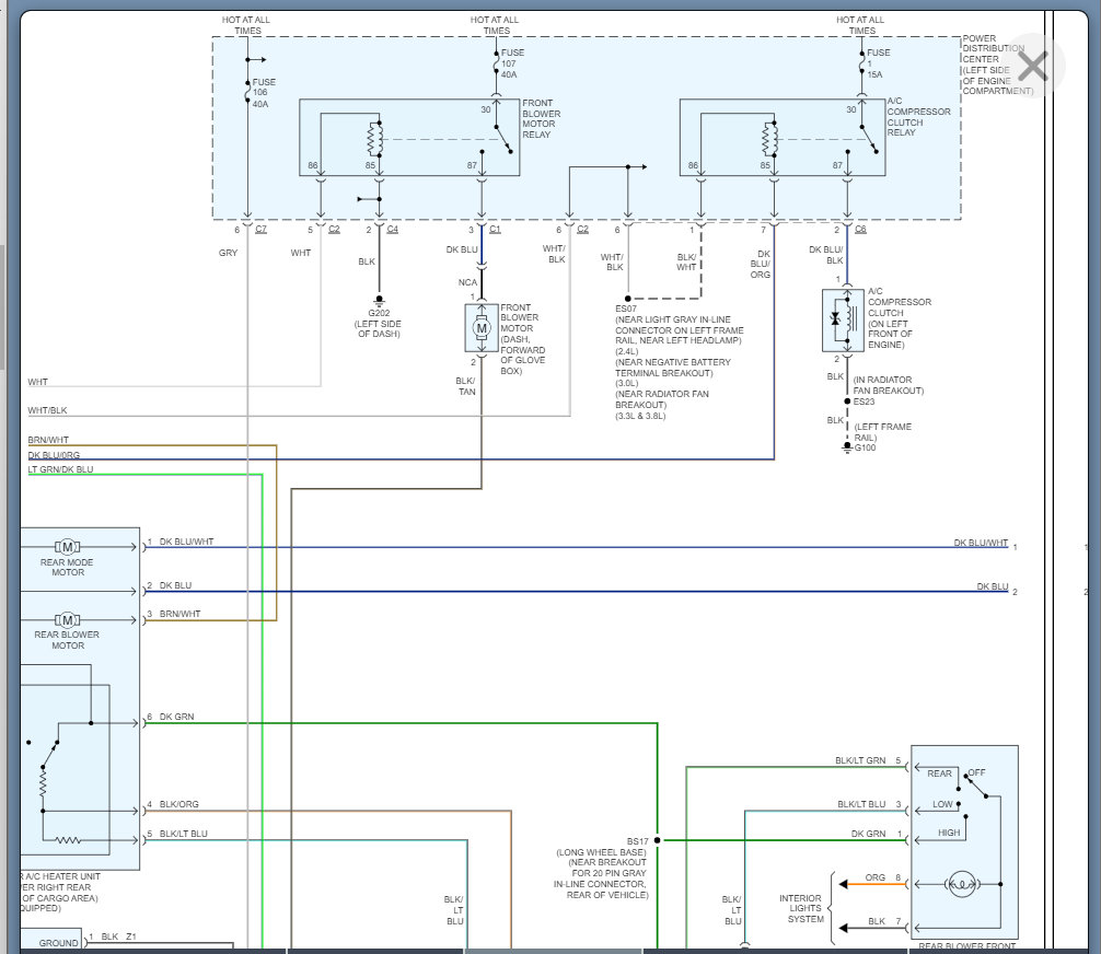

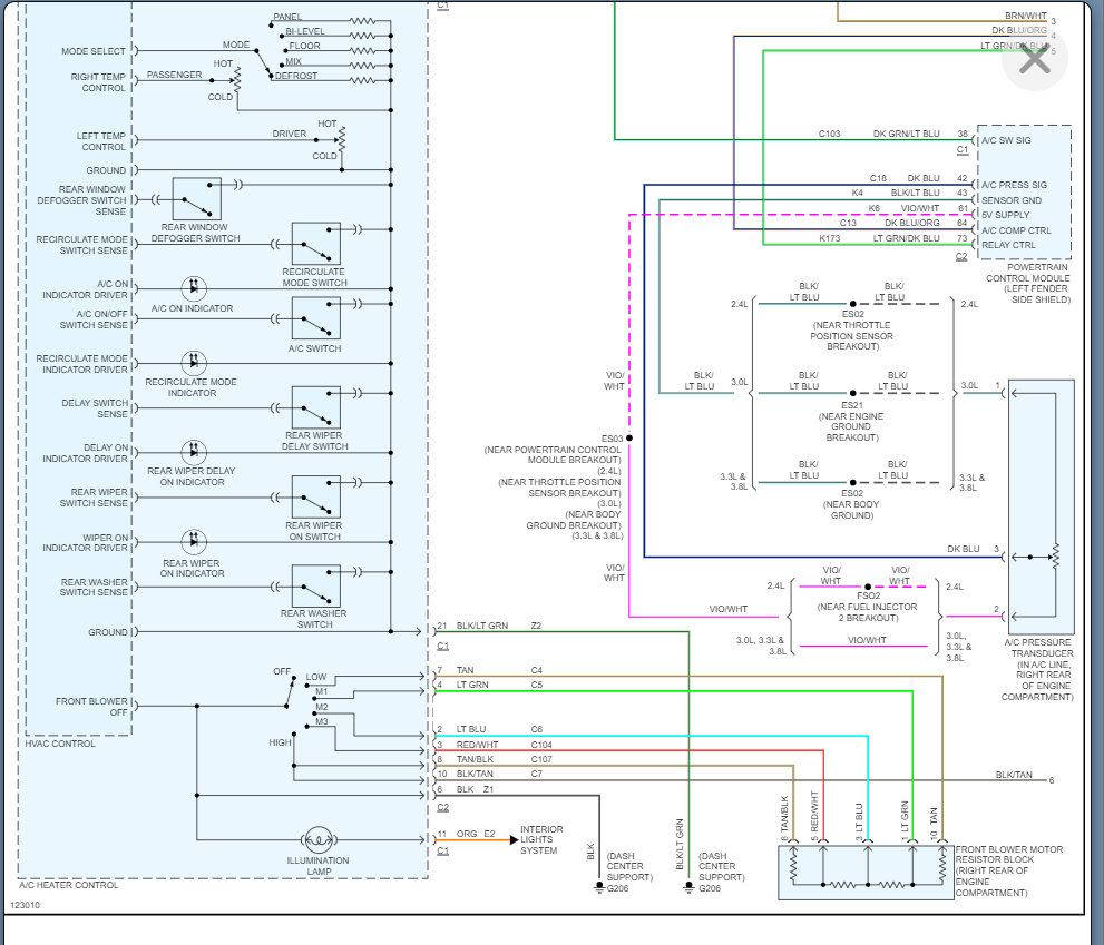

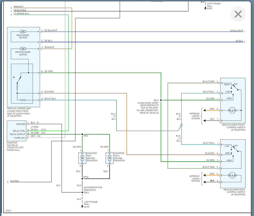

If the blower is not working at all then we need to start with checking for power at the blower.
Basically, this is going to tell us what direction to go in. It could be a ground but this is actually grounded through the control module so let's see if there is voltage at the motor and then we can determine the next steps.
https://www.2carpros.com/articles/low-or-no-air-flow-from-vents
I am attaching the complete wiring diagram below, but we need to focus on the power from the relay to the blower. Then check the ground by use pin 2 for the actual ground. You don't want to use this at first because if there is no voltage we won't know if this is a power or ground issue. So, we should always start with a known good ground.
May 18, 2022 at 6:57 PM
