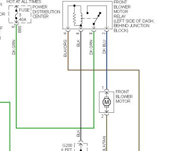

My blower motor does not work I changed it changed the temp control ck all the fuses n relays but it still does not work can u help plz

With everything turned on, did you check for voltage and ground at the blower motor connector? If you have good voltage and ground with no blower action, suspect the blower motor. Blue wire is voltage, black is ground.
https://www.2carpros.com/forum/automotive_pictures/170934_voyager_blower_motor_1.jpg
