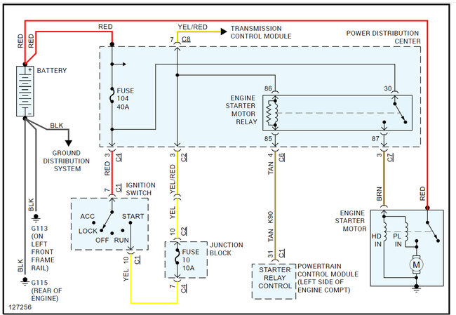

Driving my van everyday with no problem. One morning I drove the van to school then drop off friend near by then went back to school again. School finished and the van not starts at all! I replaced new starter, new starter relay and tested others with test light everything seem fine... Since got new starter and new starter relay. What is the problem and what is the next thing to solve the problem?

Look below check all the fuses involved, here is a guide to help test them.
Here is the starter wiring diagrams so you can see how the system works and which fuses to check. Check out the images (below). Let us know how it goes

It sounds like you have a bad connection at the battery or the battery needs to be replaced. Here is a video that can help you see what is wrong and how to fix it.
https://youtu.be/6YRW8fyNudY?si=SrbA030dTIWpsWsC
Please go over this guide and get back to us.
