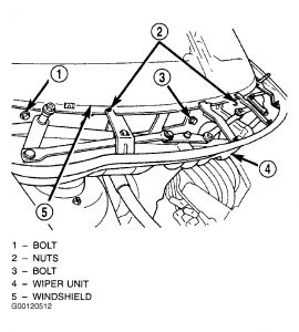

I'm afraid there is no tech info on how to remove the housing so it must be a fairly simple procedure ..a case of undoing a few screws/nuts i would think the best picture i have got is this .. hope this helps
https://www.2carpros.com/forum/automotive_pictures/266999_wiper_2.jpg
Wednesday, November 19th, 2008 AT 11:45 AM
SPRUYTTE
Do I have to remove the wiper arm's? I have heard you need a speacial tool to do that? What is the best way to remove them if needed?
Friday, November 21st, 2008 AT 12:20 PM
DAVE H
  • 13,384 POSTS
No you only need to get the cover around top of firewall out of the way. Then the altenator will come out. Like I said earlier it must only screw/bolt on because the books just say. Remove wiper shield cover.
