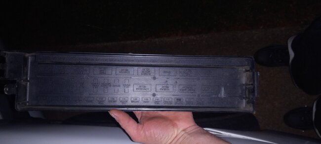

I am looking for a fuse box map diagram for my 2000 voyager. Need for under dash as well as one in engine compartment. The covers are missing so I dont have the diagram. I also don't have the owners manual. I purchased a haynes book, but its not in there either.

Hello, I came across this, not sure how accurate, you need to double check. I zoomed in trying to make it readable, this guide can help you test the fuses.
Check out the images (Below). Please let us know what happens.
May 21, 2009 at 5:59 AM
CHELL1002

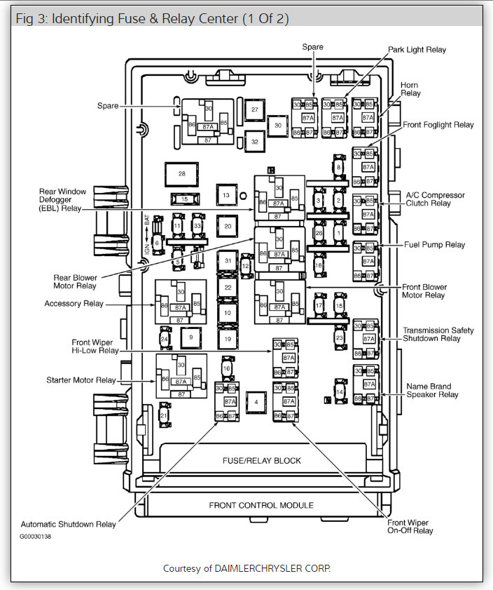

Cant really read it, but it looks to be different then mine. I also need to know what relay 11 is for.

Sorry, I can't find a label for that picture.

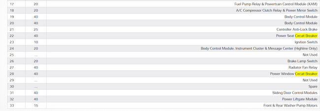

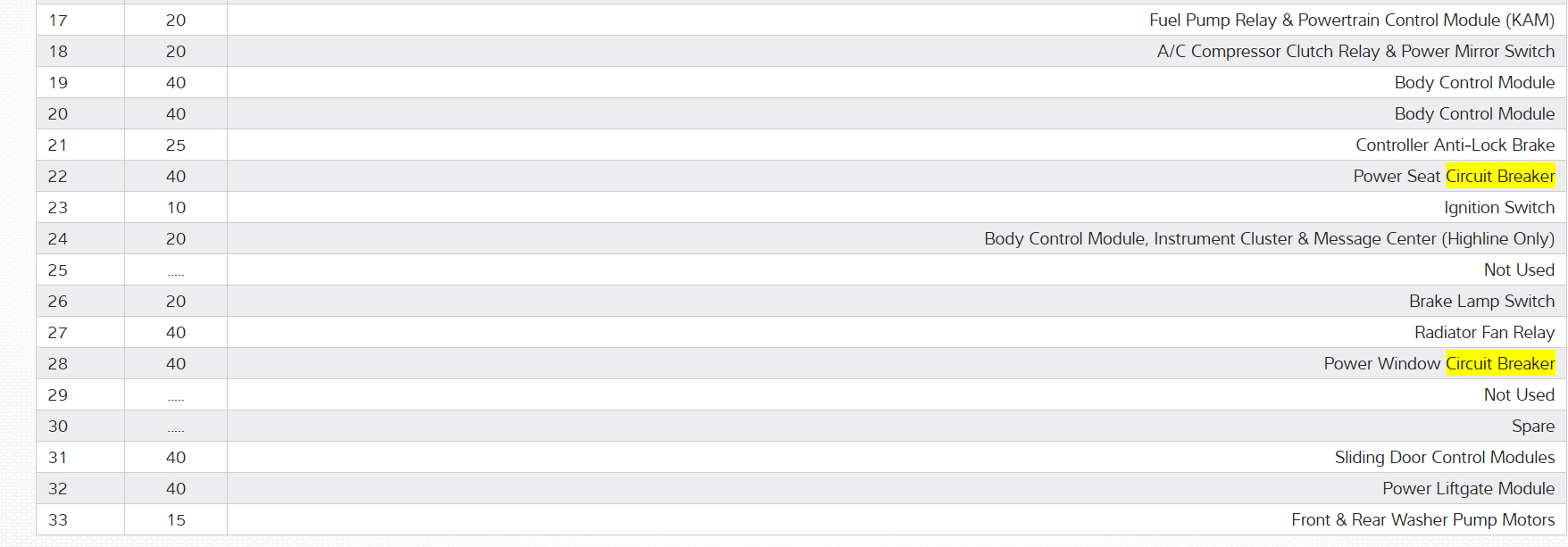

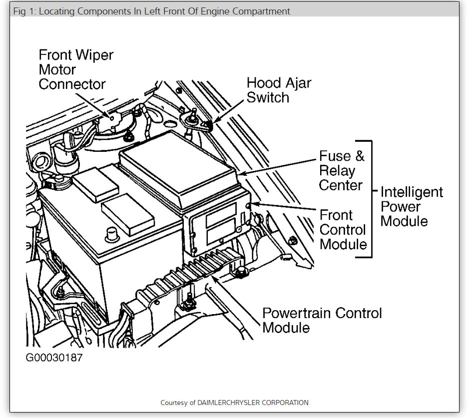

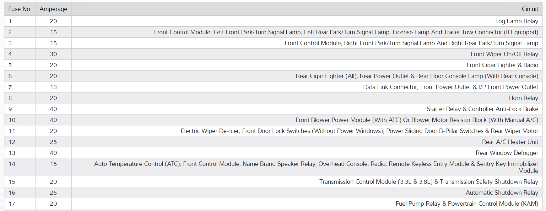

Hope this helps.
