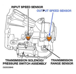

I was driving on the highway and my van stopped shifting and speedometer stopped working. engine feels like it bogs down sometimes also. What could be wrong?

very common speed sensors ( input and output ) and or solenoid pack
https://images.2carpros.com/forum/automotive_pictures/99387_tranny_chry_3.jpg
