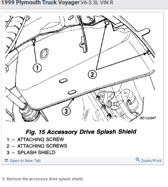

How do I get the side plate off to get to the water pump out. I cant get the power steering pulley off?
Wednesday, November 3rd, 2010 AT 8:33 AM
SQM
  • 6,383 POSTS

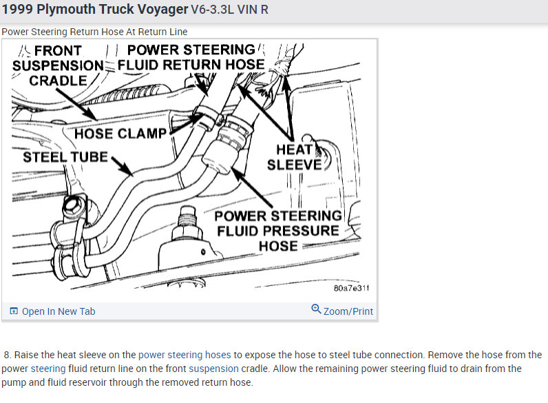

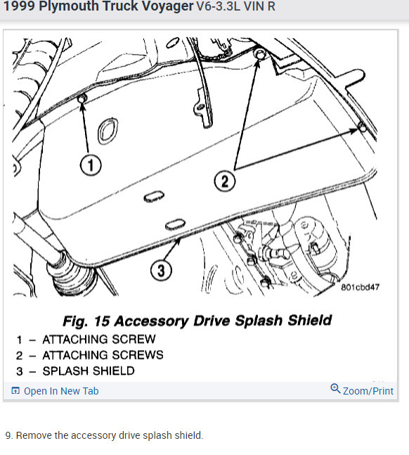

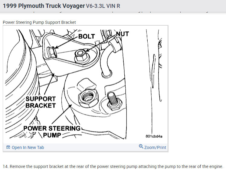

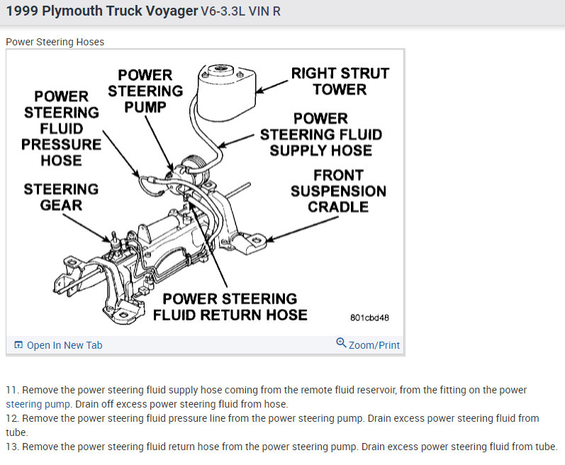

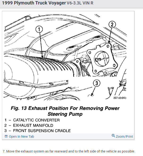

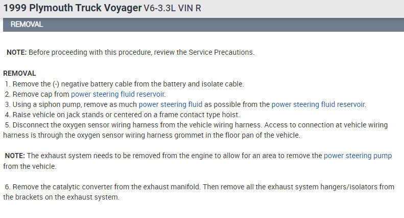

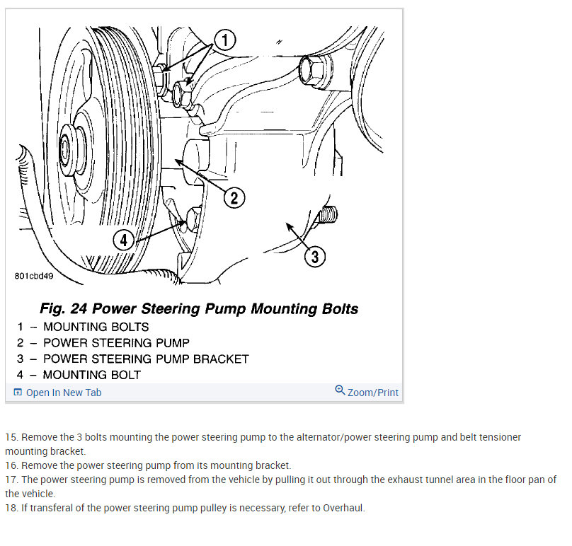

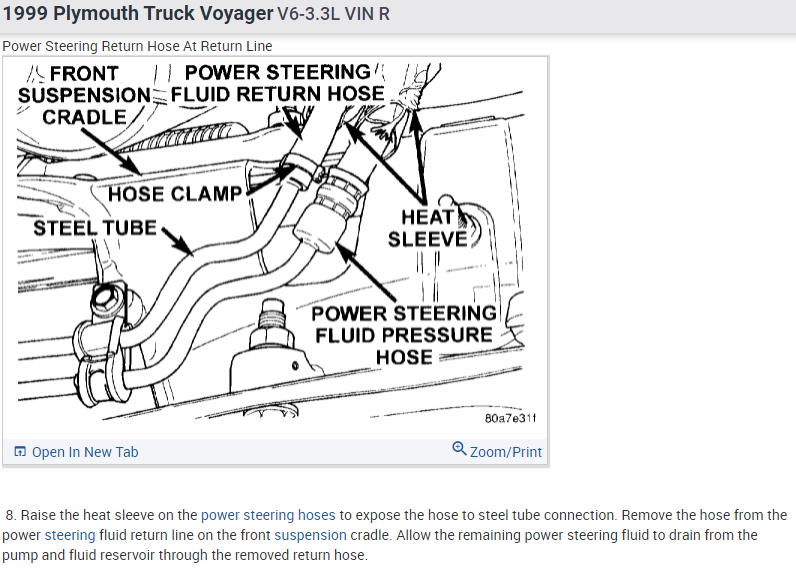

To get to the power steering pump you will have to remove the passenger side wheel well splash shield. I have attached the replacement procedure of the power steering pump (look below).
You will have to use a special power steering pulley removal tool to get the pulley off. That tool can be rented from any local auto parts store.
https://www.2carpros.com/articles/remove-reinstall-power-steering-pulley
https://www.2carpros.com/articles/how-to-replace-a-power-steering-pump

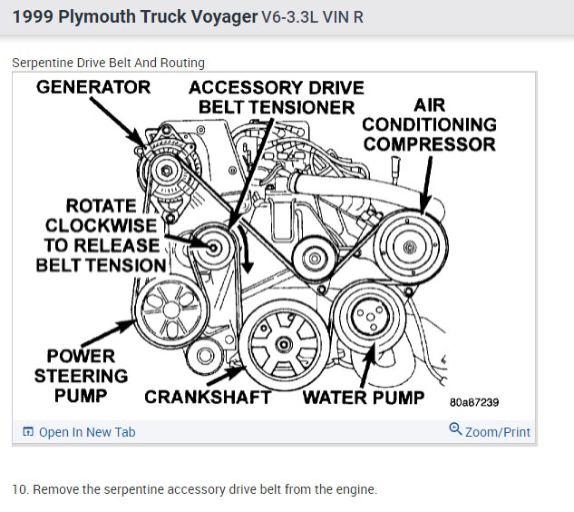

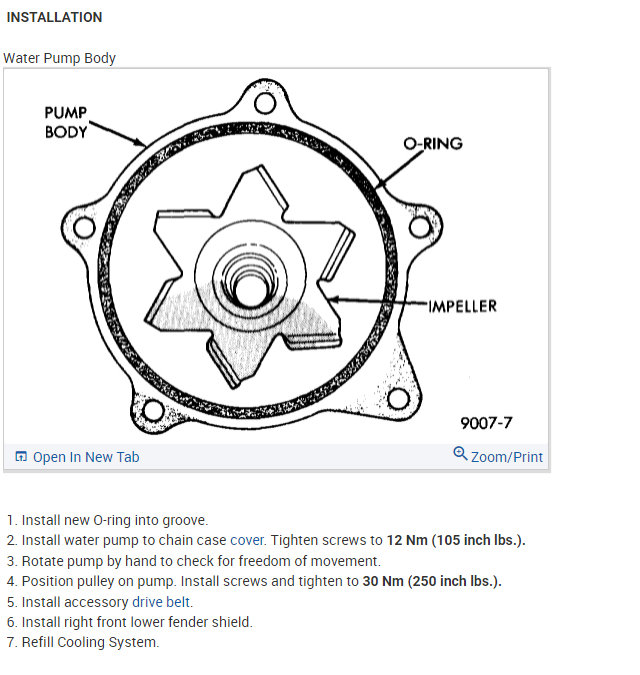

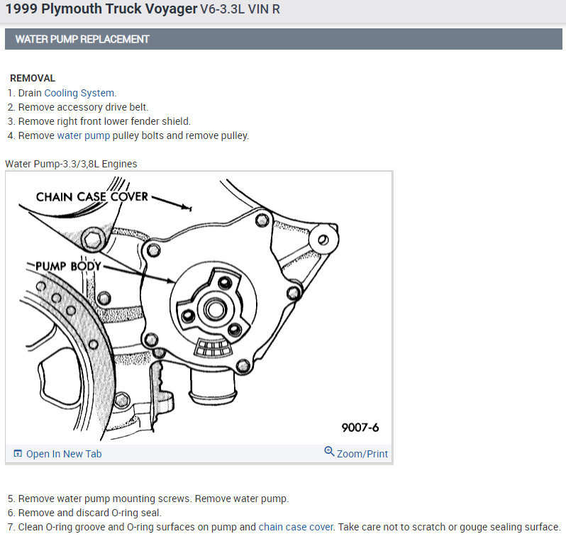

This vehicle does not require to have the power steering pump removed in order to get the water pump replaced. See diagram below for reference.
https://www.2carpros.com/articles/water-pump-replacement
