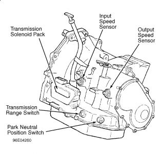

Most and very common is tranny solenoid you must have a check engine light on cycle the key on off on off on get the codes let me know what you have
https://images.2carpros.com/forum/automotive_pictures/99387_Graphic9_18.jpg
