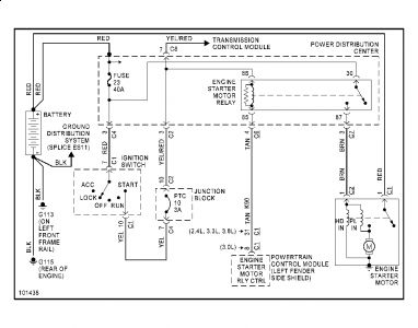

On my voyager when you turn the ignition off the starter remains ebngaged and wanting to start the vehicle. it also does the same thing w/all the wires unplugged from the ignition, fuse and relays removed and the starter has been checked and was told the starter is good. can you help out?
