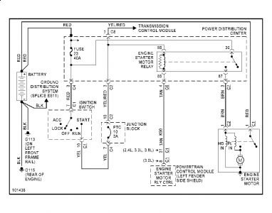

NO POWER TO SMALL WIRE AT STARTER , CHECKED RELAY , NO POWER FROM RELAY, JUMP RELAY AND VAN CRANKS

Check the red wire out of the ignition switch for power in the crank position.I have included the wiring diagram to help in figuring this out

Did you check for voltage at the relay circuits? With the key in the crank position, there should be two hot terminals. Terminal 30 is hot all the time, terminal 86 goes hot with the key in the crank position. Use a testlite.

NO POWER AT 86 , HAVE POWER AT IGNITION SWITCH

Hi, Jack gave you a wiring diagram. Sometimes the 85 and 86 terminals are switched on the wiring diagrams, did you check both for voltage? If no voltage, check the fuse circuit in the diagram.
In the past, I have started Chrysler type vehicles, by jumping the starter relay, like you did. I make sure the tranny is in park or neutral, e-brake set, turn on the key, jump the relay. It won't fix the problem,but, may get the vehicle running. Remove the jumper if the vehicle starts.
