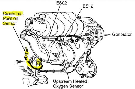

What you described is a typical crank sensor failure
located at rear of engine and in the tranny bell housing remove and replace
as for temp check coolant level if OK
remove and replace thermostat

So what you are saying is the sensor stops working while running and shuts the engine down. Then begins working again? I thought if its broke...its broke? Is there anything else that could cause this situation. I started it a few times again yesterday. It started right up each time. But the second time I did notice a slight hunting in the rpm (about 100 rpm). But the next time it was ok
Also the coolant level is fine and how would the thermostat cause the fans to run if the car was just started and is still cold? I would think its a temperature sensor before the thermostat. I just read about a control modual that regulates the speed of the fans. Could that be the problem? The thermostat just doesn't sound like the problem. Let me know what you think. Also just wondering if you do a lot of work on plymouth 3.3 engines

Yes I'm suggesting that you have a bag sensor if you like you can change it it should be easy and cheap to do Crankshaft Position (CKP) Sensor (3.0L, 3.3L & 3.8L)CKP sensor is located on top of transaxle housing, above flywheel, near corner of rear exhaust manifold.Flywheel contains 3 sets of slots areas near starter ring. Each slot area contains 4 slots in each set. As crankshaft rotates, CKP sensor generates pulses due to slot areas on the flywheel.When solid area on flywheel aligns with bottom of CKP sensor, voltage decreases to less than .3 volt. When slot area on flywheel aligns with bottom of CKP sensor, voltage increases to 5 volts. Switching of the voltage generates pulses. These pulses provide an input signal to the Powertrain Control Module (PCM). PCM uses input signal to determine crankshaft position. PCM uses input signal along with other various input signals for controlling fuel injection synchronization and ignition system.
https://images.2carpros.com/forum/automotive_pictures/99387_Capture_19.jpg
as for the coolant and the antifreeze i must missed something in your original question can you elaborate on the problem again if ac on or selector switch is on defrost the fan should come on and stay on so that is not a concern yes i do work on them all the time

funny we just had similar problem on a 99 TC this morning drive for 10 to 15 miles stop for 5 to 10 min, no good crank sensor was the problem
as what else could cause your issue if not the crank sensor ,mark ASD relay in the relay box and switch with a similar one
if no more stalling replace the marked relay
fan on as engine start have to suspect fan module relay on the front frame rail
