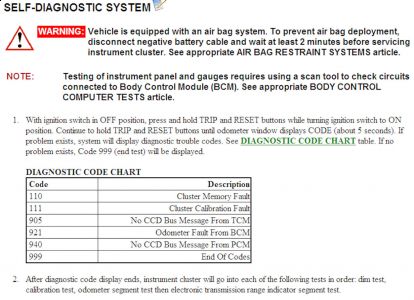

Check for the codes in the cluster.
https://images.2carpros.com/forum/automotive_pictures/30961_cara_cluster_1.jpg
Might be a BCM problem.... http://www.allpar.com/fix/gauges.html

The entire cluster doesn't receive any power, so the codes cannot be displayed. I think I am going to take my instrument cluster into an auto electric repair shop and test to see if it's the cluster or if the car is even giving the cluster power.

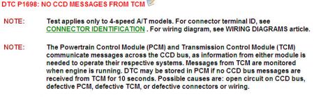

Anyways, a local shop in town let me use one of their computer tester devices, and it gave me the code P1698, which reads: No CCD message from the transition or body control module (TCM or BCM).
Do you guys think that this could relate to my instrument cluster problem? The only reason I think it does, is because the "service engine soon" light came on the second after the cluster died for good.
Aug 2, 2009 at 8:11 PM
SERVICE WRITER
  • 9,123 POSTS

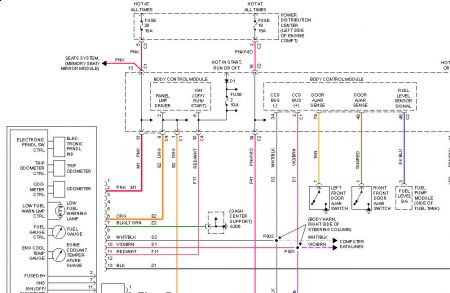

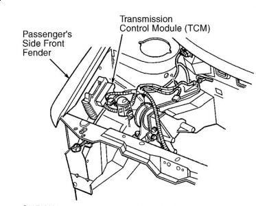

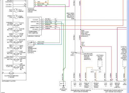

The TCM communicates with the cluster. Getting a code for this can be part of the problem with the cluster. Looking at the wiring diagram, you can see this. Well maybe you can see this lol...I can send it to you if needbe.
https://images.2carpros.com/forum/automotive_pictures/30961_tcmd2_1.jpg
https://images.2carpros.com/forum/automotive_pictures/30961_tcmd1_2.jpg
https://images.2carpros.com/forum/automotive_pictures/30961_tcm1_1.jpg
https://images.2carpros.com/forum/automotive_pictures/30961_tcm_1.jpg
