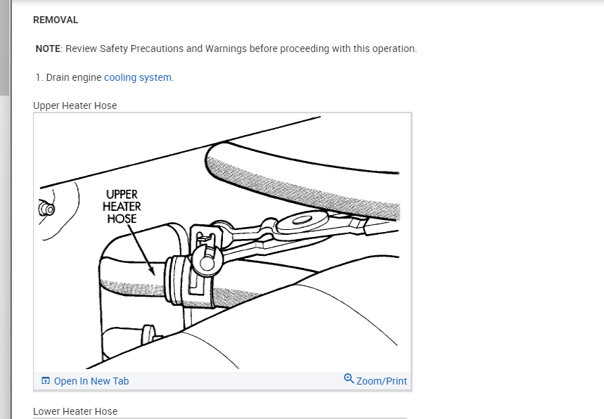

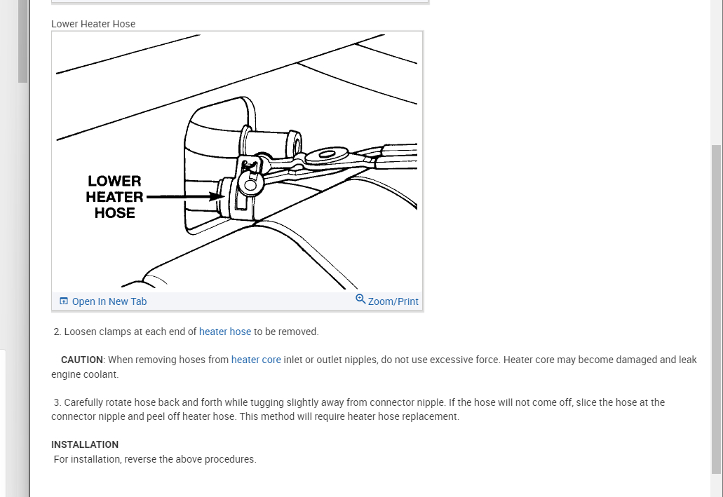

where are the rear heater hoses connected to the motor or water pump on my 1999 voyager? the pipes are rotted and need replaced. is this a back yard mechanic job or a professional job?
Aug 8, 2008 at 2:03 AM
That is not a problem. Normally the heater hoses are in the same general location for most vehicles. So here is a guide that will help with identifying them for you:
https://www.2carpros.com/articles/replace-heater-hoses
Please see the info below from the manual that will give the details on how to replace them.
Let us know if you have other questions and we can go from there.
